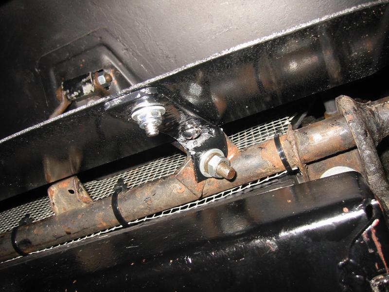

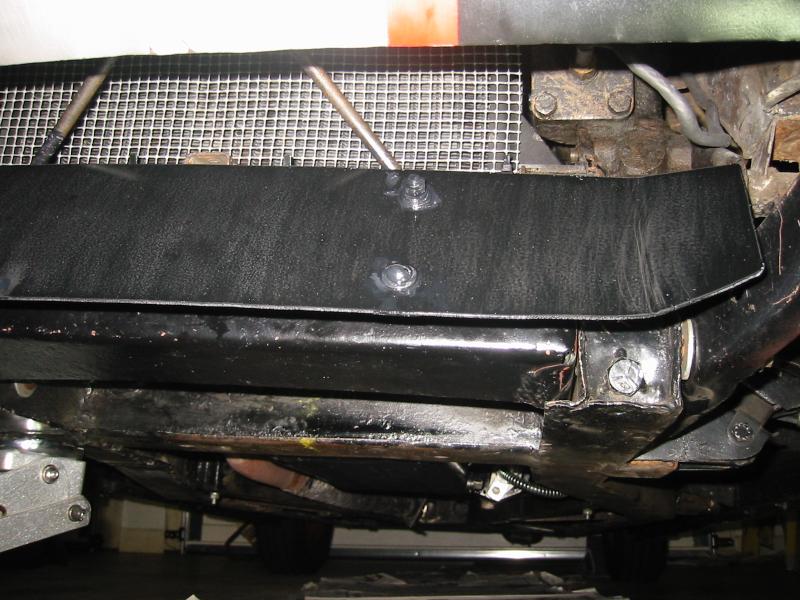

I did most of the items John suggests but none of the fuel pump steps. As John mentions when parking it while hot it tends to vapor lock and sputters for a few minutes. I have found that fully choking it when starting hot will even it out very quickly. One other thing I did is to fabricate a front damper. I believe that helps a lot by not letting the engine compartment get quite as hot while driving. The heat does build up quickly when stopped. I have noticed that even when it is very hot here in Raleigh, in city driving if I can get up some speed between stop lights the damper drives enough air up into the radiator and engine compartment to cool it down just between stop lights. Doesn't help in stop and go driving so for that I turn on my electric fan override switch. Attached are pictures of my air damper.
Regards, Bob
