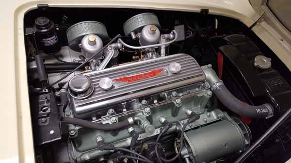

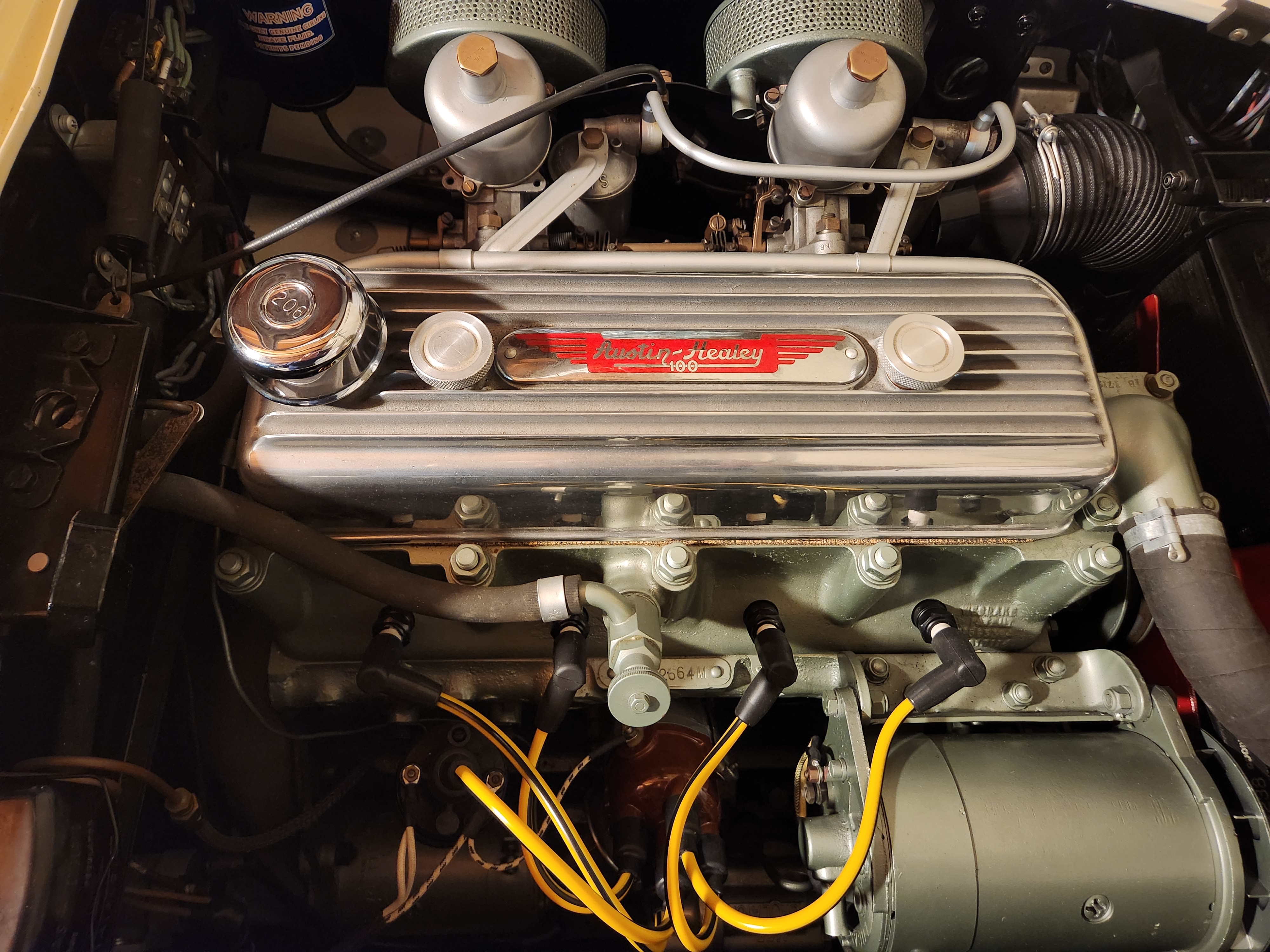

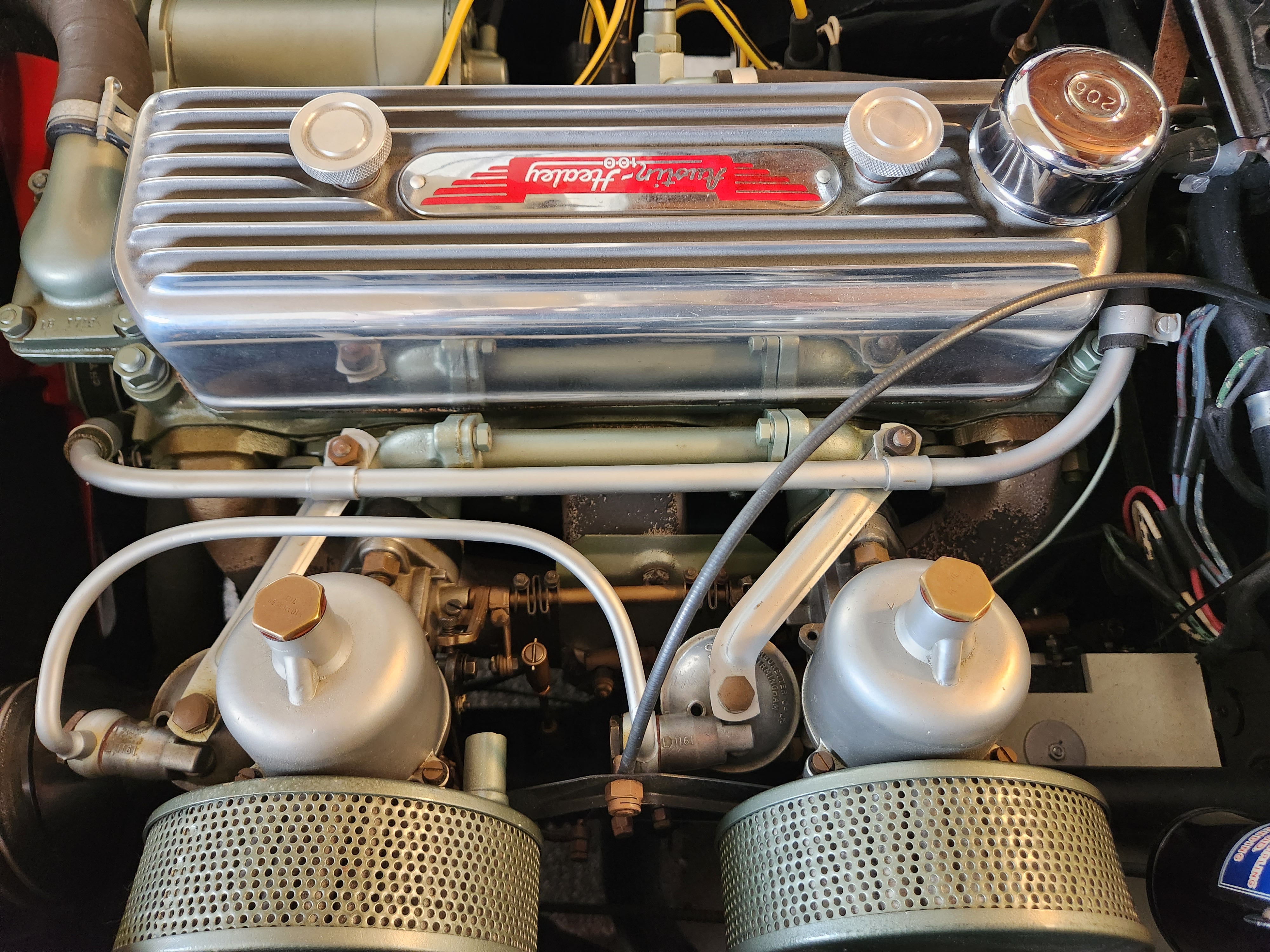

Thanks Reid. I hope to add a lot of value to this forum.
In my introduction I described my Concours judging philosophy and that originality while the goal, can be improved upon with discreet or unseen modifications to make you AH run better.
As such, the engine on my Jan. '55 built BN1.
Unseen mods...
- 100M pistons
- 100M camshaft
- Original 12 54 dated distributor upgraded to M specs by Geoff at Advanced Distributors
Discreet mods...
DW standard aluminum road head. This head improves airflow significantly is much lighter and more durable. It doubles the rpm power band and is virtually indistinguishable from the original.

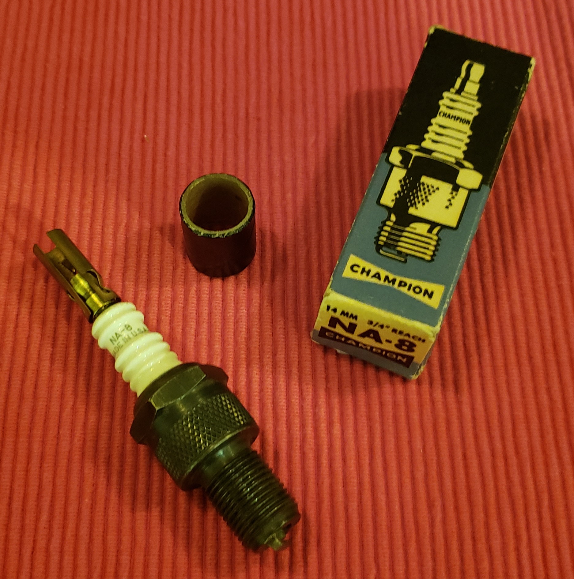

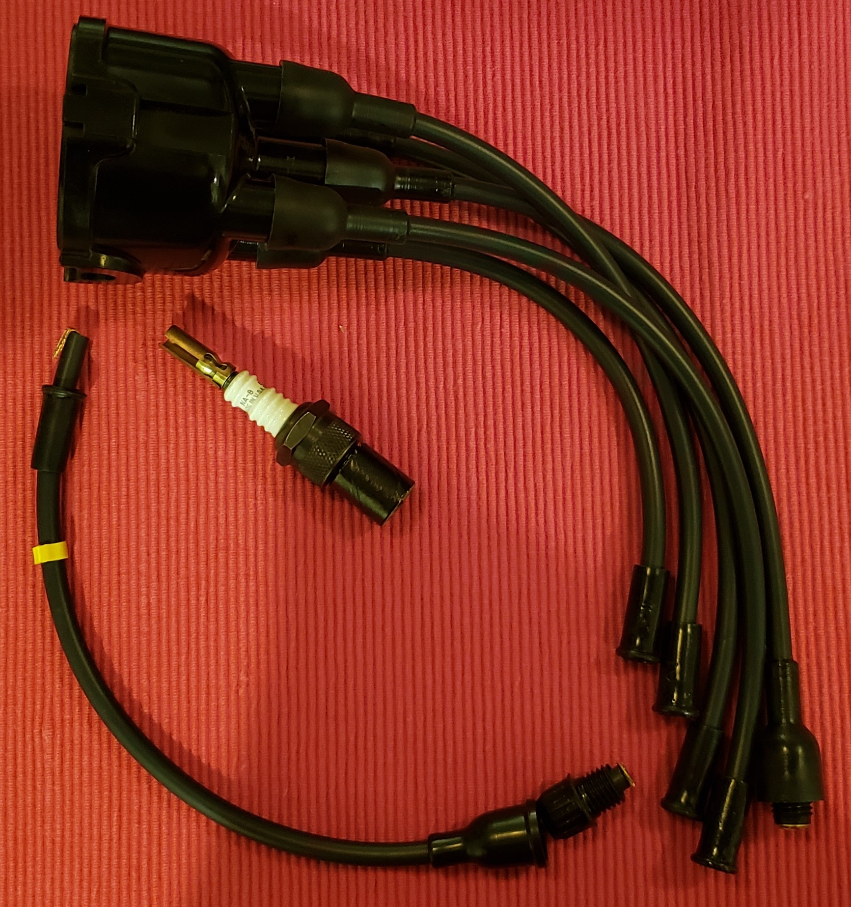

While I drive with a set of upgraded "Bumblebee" wires, waterproof leads and an NOS BREMI cap. I have a complete original, all NOS set of wires, LUCAS cap and copper leads, plus NA 8 spark plugs for judging.
The original restored 9-finned aluminum valve cover is approved by Concours with no deduction.
Bottom line, my engine is equal to or better than a Factory 100M setup with an H6 carbs and unmodified cast iron head. Concours does NOT equate to trailer queen or lesser performance.
