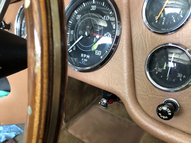

My TR came with the mod you describe. The toggle is located below the OD switch which is also a toggle. I have a new control head but have yet to install it. I took me a while to remember to turn off the turn signal after making the turn. It's habit now. As far as the wire colors and how they are connected I really don't have a clue. It works and I'm ok with it even though it's not original.

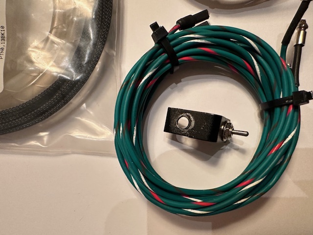

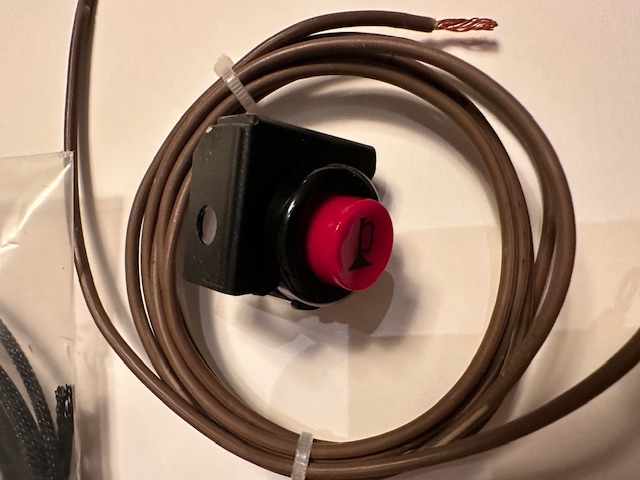

I used a mini guitar switch for the turn signals and a heavy duty push button for the horn mounted on the underside of the dash by my right knee for years after a frayed fan belt took out my original wiring. I just repaired all of that back to original. I think I still have it all, color coded wires that reach out to the driver’s side horn to the original harness connections. Let me look in the garage mahal. It’s all yours if you need it, pass the favor to the next person.

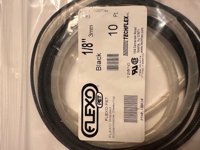

Found my stuff. Message me with an address and it's yours. Do you need the horn switch and wiring? I assume UPS is better than US postal service going to Canada - your thoughts? The FLEXO braided expandable sheathing is example only, you need a larger size for 3 or 4 wires. It looks similar to the cloth taped wire bundles. I routed the wires through an existing grommet in the firewall.

Not sure why I had a picture of just the turn signal installed. The horn switch was just to the right.
Both in existing holes.
