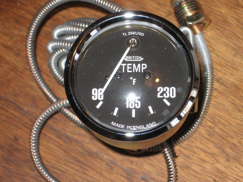

The last NOS temp gage sold on Ebay for $325, about a year ago. I watched for 4 years and finally got a trashed gage with a face that is in good shape to transfer to my working internals...and I paid $80 for that. Of all the gages, the temp is by far the rarest currently.

The guy on E bay that builds new look a like gauges do look good. At a casual glance or a fairly close look it will probable pass except for very knowledgeable people.

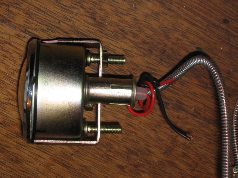

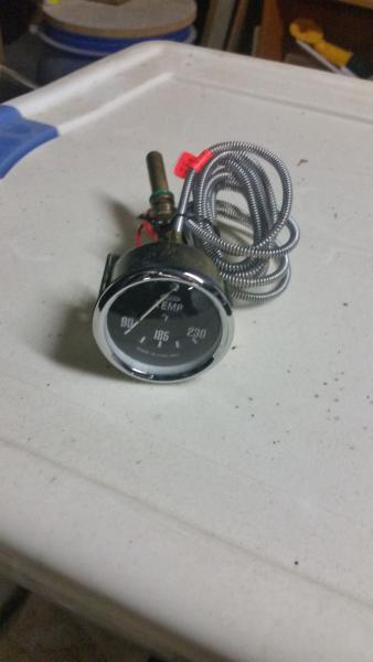

martx-5
One of these days I'll get around to repairing my original. In the meantime, I bought one of those replacements from ebay. It's a fairly good representation of the original. but there are some significant differences if you look closely. Also, it has it's own lighting which is different from the original. I've been using it for a few years now.
Here is the listing for the gauge on ebay...https://www.ebay.com/itm/Triumph-TR...ash=item239c5c95e9:g:JDEAAOSwqYBWmIGv&vxp=mtr

Art, I have been watching that Ebay "clone" add for many years. I am pleased to see it is actually a really well done repro. I think even an OCD Triumph guy would have to do a few takes to tell it's off.
