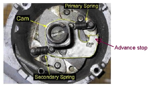

And in that picture that Randall posted, you can see the 15 degrees stamped on the arm, indicating that this distributor should have a max of 15 degrees of distributor advance (30 degrees at the crank).
Right, but note that probably is not a TR3/4 distributor in the photo. Marcel was writing about a classic Mini.
It depends on the distributor model, but most TR2-4 would have had a 14 degree stop (for 32 crank degrees total advance with 4 degrees initial).

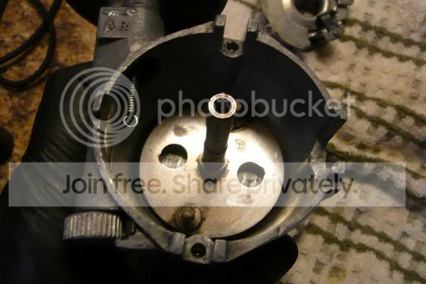

Okay, have out-of-town guests due to arrive this afternoon so I have to hold off opening up the distributor in question but did take a peek inside my spare. I do not see the 'arm' or 'stop' described in Marcel's article, though just eyeballing the advance it seems about right:
Well, something stops the movement of the weights.
You have a DM2 there, while the article and photo was for the later 25D. I forget offhand where the stop is for a DM2; have to go look at one.

Okay -- just to tie up a loose end should anyone care now or search later...
The weights in a DM2 distributor have a short peg under them that sits in a much larger hole in the plate below. Their swing (and thus the advance) is limited when that peg runs into the edge of the hole.
You can see a slight 'dent' in the edge of the holes where each is hit by a peg.
I don't know if that 'dent' is a result of years of running or is original and the depth of it used to control the amount of the advance. Alternately, the size of the hole itself may determine total advance.
