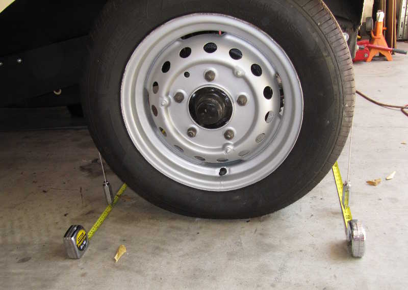

I have used the bright orange string method and it did not reveal a major problem but you can't get totally precise toe angles with it.
If you set the car straight ahead you can set the toe with a steel tape measuring behind the wheels , then in front of them, from the same place on the tire of course. Its crude yes , but careful work can get it close so you have some toe in.
About 1/8th inch toe in should solve your problem. That's what I have my TF set at and it tracks perfectly. PJ

If everything is assembled right, you should be able to get a decent alignment with two tape measures, as long as you have a flat surface to park the car. I do this with my TD and my 67 Porsche; I use two plumb bobs over the tires, in a narrow tread groove.
When the wheels are aligned, there should be plenty of threads visible on the tie rod and you should be able to get plenty of toe in. I like Paul's suggestion of an eighth inch of toe in; that might be all you need to solve the problem. So much of this depends on the differences between modern tires and the ones for which the original specs were developed, so you may have to experiment a bit.
