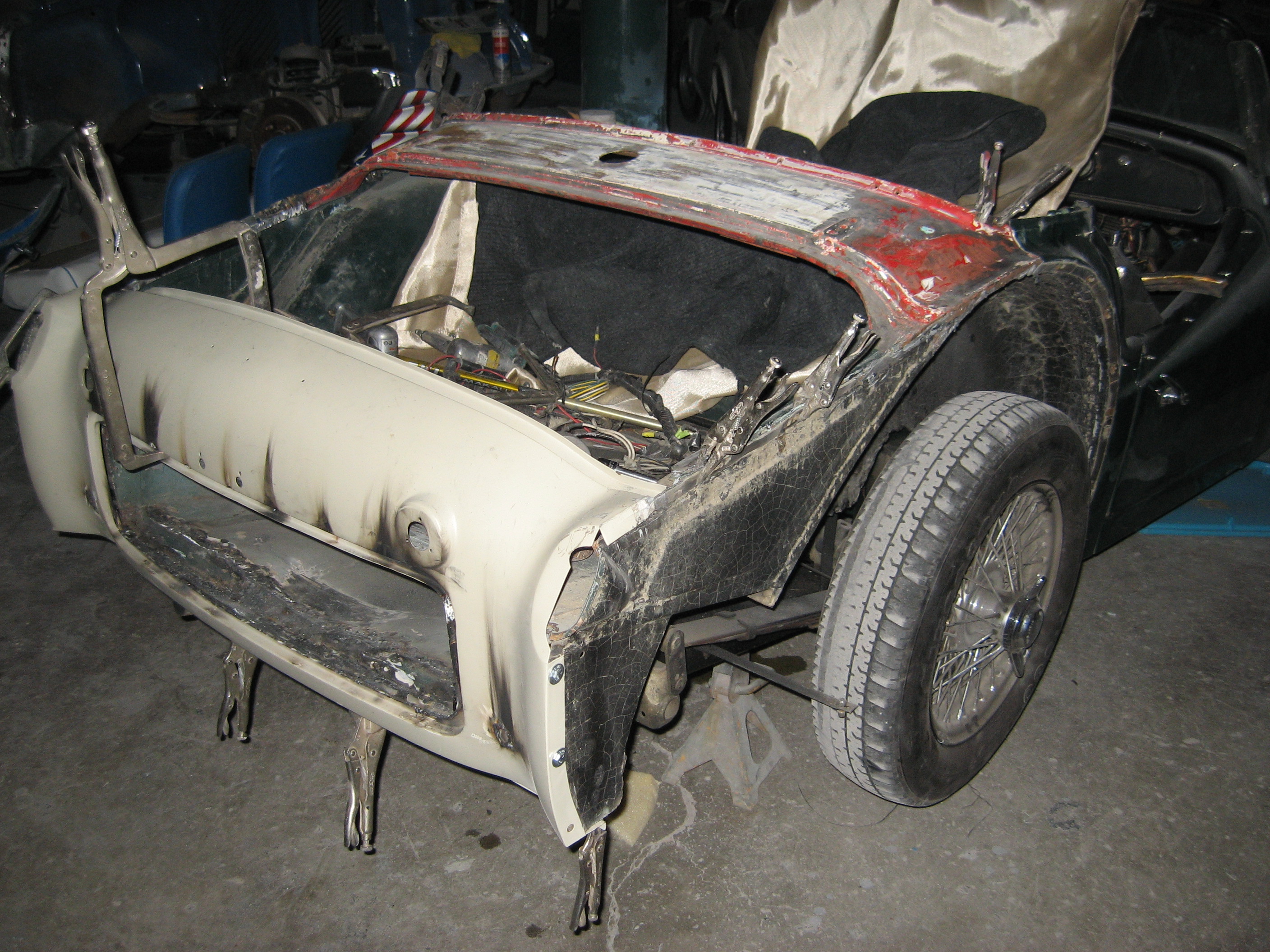

mctriumph
All of which do nothing when you are stopped at a light and a 3/4 ton F250 dont see
your LBC, and parks in your boot. Could have been catastrophic as the fuel tank
was compromised...... (see the fist picture in this post)
