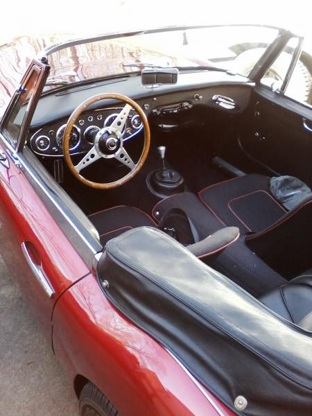

Decent radio and speakers. I attached my stereo to the bottom of the heater box, in a black plastic housing.
I have fitted a few driving light on the front - two Marchal 662 / 762 spots in the middle and a couple of Lucas Fog Rangers, one on each side slightly angled to pick out the sides of the road. The poor old dynamo (generator) fails to keep up with the demand so the next add on will be an alternator. The badge bar is mounted off brackets, fixed to the front irons, the front valance has been taken removed and the fogs are mounted off brackets also fitted to the irons.
I have also installed some of Vredestein's finest Classic tyres and find them very acceptable.

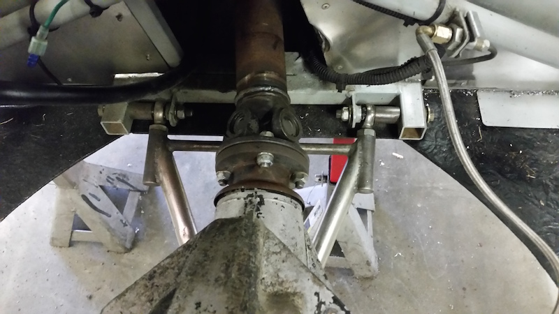

Randy: what is an 'articulated A-arm locating rear axle'? do you have them available for sale?
And I forgot to mention for ours: stainless steel exhaust system. I'd like to find someone with a mild steel exhaust and do a sound comparison (not loudness!) as I think I prefer the 'sound' of the original stock system.
Randy can correct me if I'm wrong, but I believe he means a setup much like my Courier has:
You can see the A-arm in silver. It locates the rear axle laterally like a panhard bar, while also minimizing changes in differential nose angle.

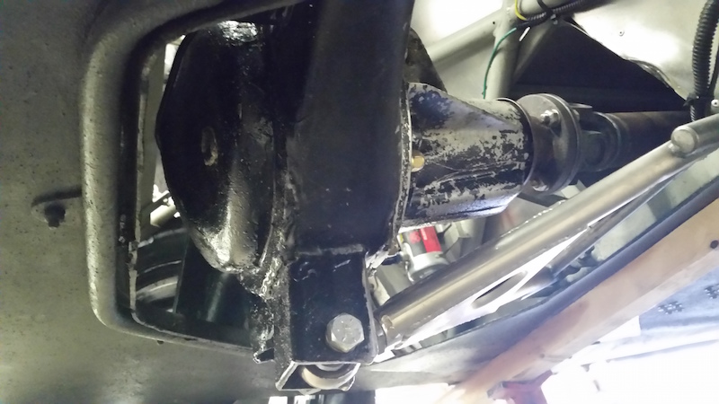

Pictured below, it's just something I fabricated to rid myself of Panhard Rod characteristics (hard cornering in one direction reacts with jacking up one side of the car).
No correction necessary, as that is exactly what I mean. I got the idea from a Lotus suspension, but I did it so many years ago, I don't now remember if it was the Elite or the Cortina...
The Articulated A-Arm locates the axle laterally, limits torque reaction from accelerating and braking, and also lowers the rear roll center of the car.
Since Randy and Mike have already hijacked this thread I'll pile on. Attached are a couple of shots of the link on my Ginetta G4 which mounts between the longitudinal frame tubes and the center section of the rear axle. It serves to both locate the axle laterally and prevent wind-up/jacking under braking/acceleration.

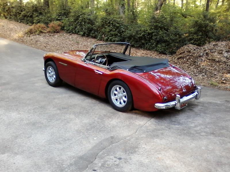

twas brillig....the tires are 195/65 by 15 and 225/60 by 15 on the 5.5 and 6.0 minilite bolton wheels. i also like the speedhut gauges with gps speedometer with built in gas gauge. all gauges fit the standard healey openings.
