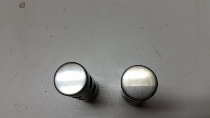

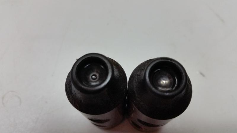

Over the last few years my AH 3000 BJ7 has developed noisy tappets. Valve adjustments by 13-1 rule to spec still results in valve train clatter at idle Engine runs smooth, no overheating with 55psi oil pressure at speed and 25 to 30 psi at idle when hot. Just those noisy tappets, particularly for valves #7, 8 and #9 using a stethoscope. Valve cover off shows good oil lubrication throughout valve train. Oil seeping through holes; no geysers. Rockers are good. Dismantled valve assembly, removed pushrods and lifters (tappets). On inspection, the condition of both pushrods and tappets is disconcerting.
Pushrods show ball seat wear with corresponding wear patterns on tappet cups. Some of the tappets cups appear to be worn through or wearing through and have what appears to be pin holes. The cam facing side of the tappets are clean with normal wear pattern for a 50K mile rebuilt engine (trying to upload pics). So, a few questions:

Gonz What shape are rocker bushings and rocker shaft in ? Were some valves too tight ? Tappet on the right has some wear. Should be a slight crown but not visible by eye. You can see it was spinning which is good. If you can see that cam lobes are good you can put new tappets in and break it in again. Put moly lube or break-in lube on all parts. Good luck :tennis:
The six cylinder engine is very quiet when it's in good condition and the rocker shaft has to be very worn to be noisy, whereas cams and followers get quite noisy if they're worn. If either is worn you'll have to replace both as I've just done and you can just about do it with the engine in the car.
Having just been through all this with an engine imported from the States, I've just bought followers from Piper Cams Ltd and had them reprofile the camshaft. The ones I bought from an official UK outlet were poor quality and 3 thou undersize, so I sent them back. Therefore I'd find an American company who reprofile Camshafts and have them supply the followers to be sure of quality.

ive read that the zddp additive to your oil isn't as good as oil having it already formulated in it. I've had tapping noise to two of my engines that turned out to be broken piston rings that ended up on top of the piston along with some piston particles. On my last engine I used a stethoscope and the sound was loud on #1 piston area but it was #6 piston that was bad. I hope this is not the case with your engine. You might see if you can borrow a bore sight tool to get a look at the piston tops. Your lifters look good. Check rocker arm surfaces that hit the tops of the valves for a groove. These can be also fixed.
