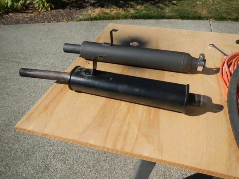

That's not the Bullet shaped one then but also works. I tried one like that but with baffles punched out made Bugsy sound like a Rice Rocket. See pics earlier in this post of the the one Kelly and I have been using.

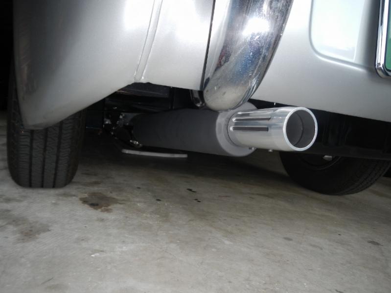

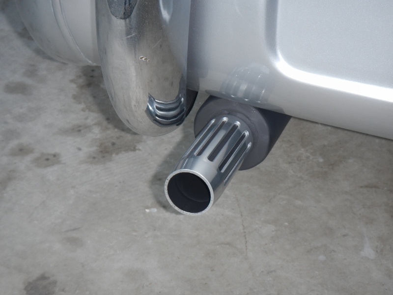

DSCN1398 (800x600).jpgDSCN1400 (800x600).jpgDSCN1402 (800x600).jpgI didn’t touch the baffle. I put it on just the way I got it. It didn’t have a name on it. Came of a Road King. I have nothing to compare it to not having ever heard a 1275 with a Harley muffler.
Baffle Tip adds a bit of sportiness.
