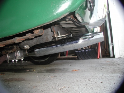

Just search for Harley Muffler on this site. The bullet shaped one is the one you want. A couple of adapters tack welded together to get you t o1.75" pipe and you are good to go. muffler 002 - Harley resized.jpg
A coupe more pics. Kelly has posted lots of info on taking these apart and doing some additional work on the baffles but I used mine as received for free from the local Harley Shop out of their too nice to throw away take offs bin. Wander back to the service desk and ask if they've got any take offs in their trash pile. You may get lucky.

Someone else may correct me but I believe 2". I needed 2 pipe adapters to get from 1.75" to the Harley input size. Tack weld them in place as I discovered real quick that clamps would not hold them. No torch / MIG yourself, a trip to local Muffler shop and $20 ought to get you taken care of.
You don't need an adapter if you have a stock pipe. Cut the flange off, jam it on and weld it. It fits perfectly that way.
IIRC the Harley muffler I had (a Harley "Shorty") was 1.5" on one end and 1.75 on the other. Perfect fit, correct direction, no adapter, slide on, tack in place.
Well the one I had needed a couple of adapters to make right. the adapters also moved the end of the pipe out by about 2" to exactly where it needed to be. Again Muffler was a freebie takeoff with a little dent that did not show on Bugsy I. A strap hanger and bolt to fit in the mounting slide and I was good to go. Adapters are no big deal if needed just tack weld them on. Muffler clamps were not enough as my pipe did not have the transmission brace / clamp on it so only attachment point was the donut to the header and the mount at the rear. Worked fine for 5-6 years.

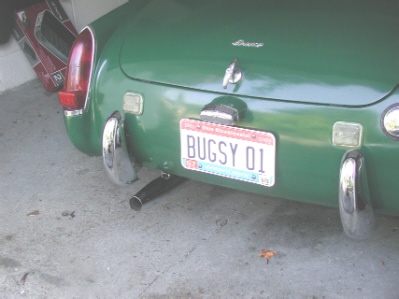

I don't like 'em for a few reasons. 1.) reduces velocity with stock size pipe: Stock on the 1500 is 1 1/2" IIRC, you go from small, to bigger with adapter, then back down to small again inside the muffler. The inside of the muffler is the next step up from the stock pipe, hence you don't need an adapter and you're killing velocity right when you need it, before a restriction. 2.) They cost money: I can't see a good reason to use them since in is already built into the muffler, you just have to cut the factory muffler flange off. 3) Not exactly clean looking. With the 1 1/2" pipe you have to use two adapters, things can look bad like that. Now I hear what Jim is saying about using them will move it to where it needs to be. I did the same thing with the factory exhaust tip from my old muffler. I cut the straight part off and used it as an extension. I coupled it to the factory pipe with an exhaust coupler for a total cost of about $4. With clamps and everything for adapters I think it came to about $20-25, which is crazy when you think about it. Mine may very well be the exception as my factory sized stuff was still in good shape. Did I ever post a pic?
Kelly, back when I did this I was on the cutting edge of using a Harley Muffler. Many others have gone that way since and there are better ways of doing things and more knowledge available. My brain figured out the simplest way to get from Point A to Point B and that included the simplest ways to get the muffler to mate with the stock pipe. So the quesiton becomes, has he found Muffler yet? Post a pic and we can give advice. If not, Saturday Morning at the local Harley Shop. Bring some donuts and find a "freebie".
