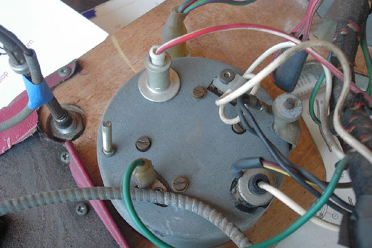

Here you go.

One thing to note about Greg's picture is the white wire's loop around the tach sensor mount is too loose. When installed this loop should be tight around the sensor's mount.
By the way, on Greg's picture, the white plastic mount is upsidedown and missing the metal "staple" on the outside as well, which it won't work unless you have that on there.
