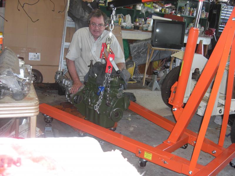

I had one seize on my startup and it threw itself across the garage. Lucky I was not in the path PICT0017.jpg

I had one seize on my startup and it threw itself across the garage. Lucky I was not in the pathView attachment 40369
Jeeeeez! I would have thought something would strip or shear internally before ripping itself free from the generator! I'll move the "lubricating the tach generator" up on the priority list of "before first start tasks".
