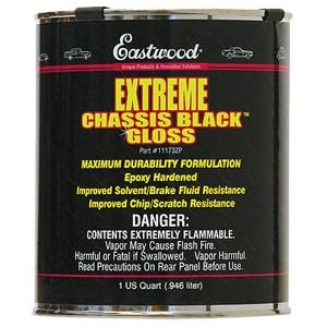

I'm using Eastwood 'Extreme' chassis black gloss which is quite tough as far as paint goes but isn't that good to paint onto cast surfaces because the black pigments pull away from the high points. Have done all the black stuff now in it and despite the above, I'd still go with it again.
Buy a small cheapie top-feed spray gun that you can leave hanging on the wall with paint in it, that saves a heap on aerosol cans and is ok for a couple of weeks without drying out.
I used the satin version of the paint for the heater box and will do the petrol tank in satin too I think.
Andy.
I spoke with Roger Moment last weekend and asked the exact same question. His reply was Eastwood's satin extreme chassis black was the closest.

Used the Eastwood products as well - have had great results with them and the color match for touch up is great, and ther is always touch up....
