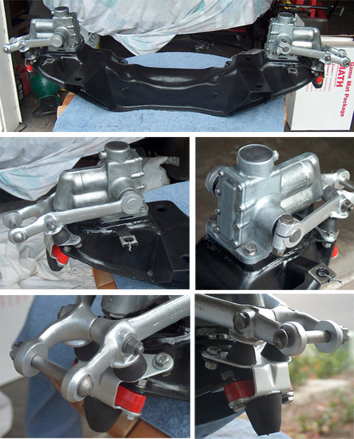

I painted the main body of the suspension gloss black and the lever shocks I wire brushed to a nice aluminium finish and clear coated them. Take a look at the attached picture.

[ QUOTE ]
[/ QUOTE ]
/ubbthreads/images/graemlins/shocked.gif Thier too pretty to put on the car! /ubbthreads/images/graemlins/thumbsup.gif PJ
