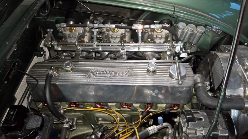

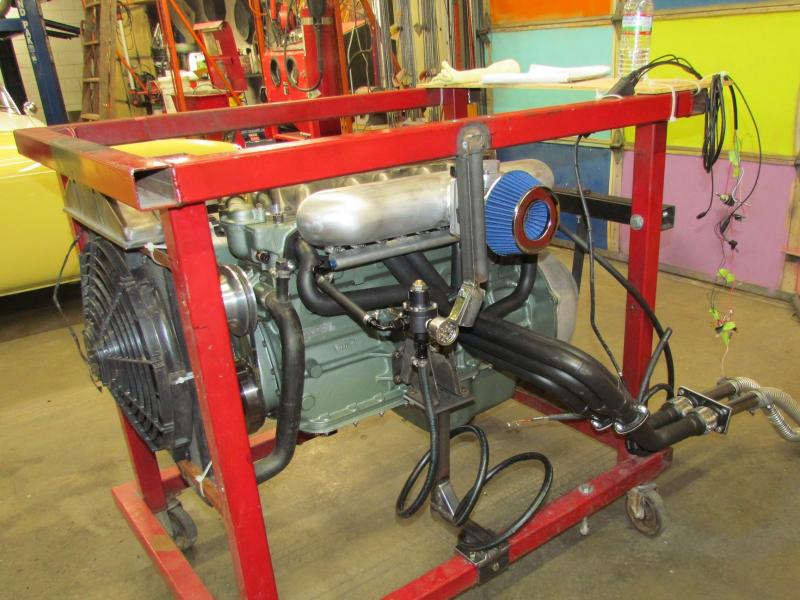

Much as I like the valve cover, that manifold is a thing of beauty. What are you planning for an air filter?
Thanks Rick. The air filter hasn't been settle on. I could use a regular filter which is easily sourced (there is room), and I may end up with one of those (pictured). OR, if I can work out the spacing, which isn't that easy, I'll have a cool/fresh air feed from in front of the radiator to a inline filter packaged in the cool air tube. I should know within a month if I can fit the cool air package.

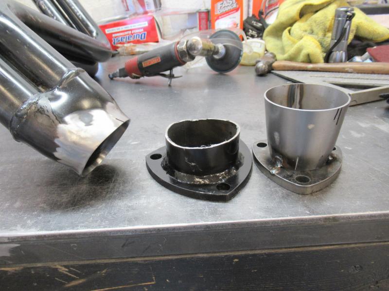

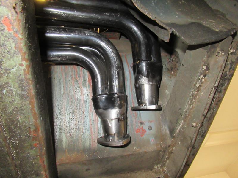

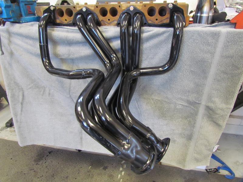

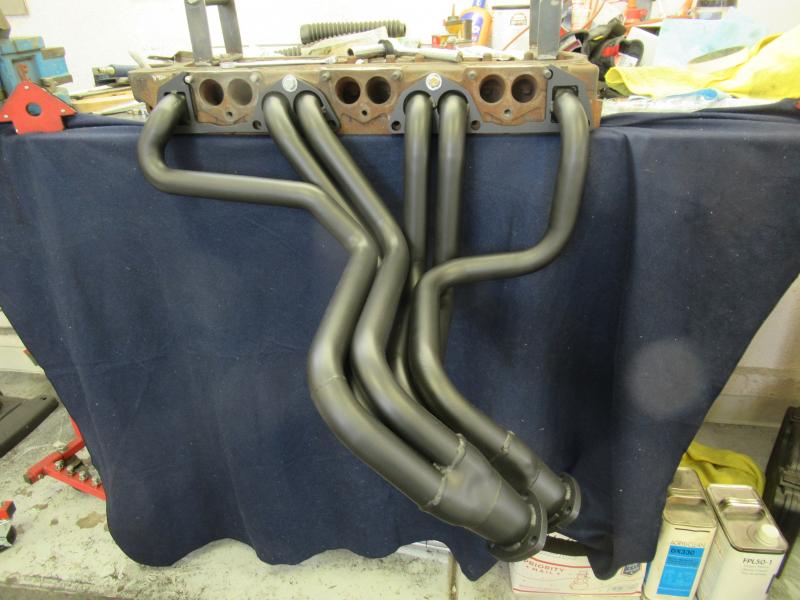

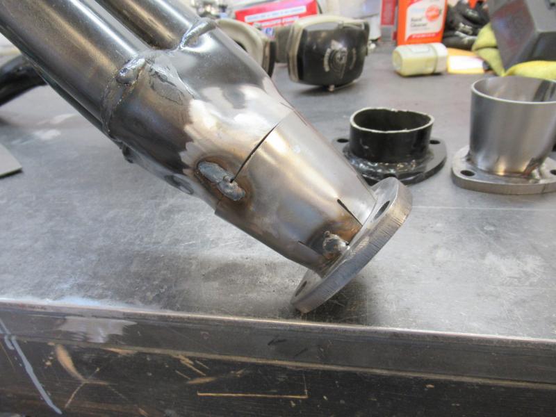

Kirk headers?
Bob, well, yes ... for the most part... but the number one pipe has been replaced with one that is not a slip joint and doesn't go around the left side of the engine mount (I don't know why they didn't do this on the originals as the new location tucks in nicely). Then the collectors were replaced with ones more appropriately sized for the engine... 1.75" flange and positioned to improve connectivity. I like the Kirk's because they have smaller primary tubes (1.5") which keep exit velocities higher than would a larger tube. That's better for a street engine which spends most of it's time in mid-range RPM's.
Original unmodified Kirk
1 Original Kirk Headers 0974 S50.jpg 5 New 1 pipe and collectors ceramic coated 2583 S50.jpg 1 Stock collector left new cone RT 0974 S50.jpg 3 New collector w 1.75 flange  0974 S50.jpg 4 IMG_5124 (10) S50.jpg

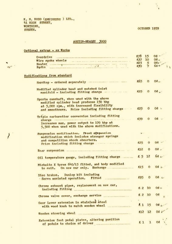

Interesting Ruddspeed period upgrades and performance additions....

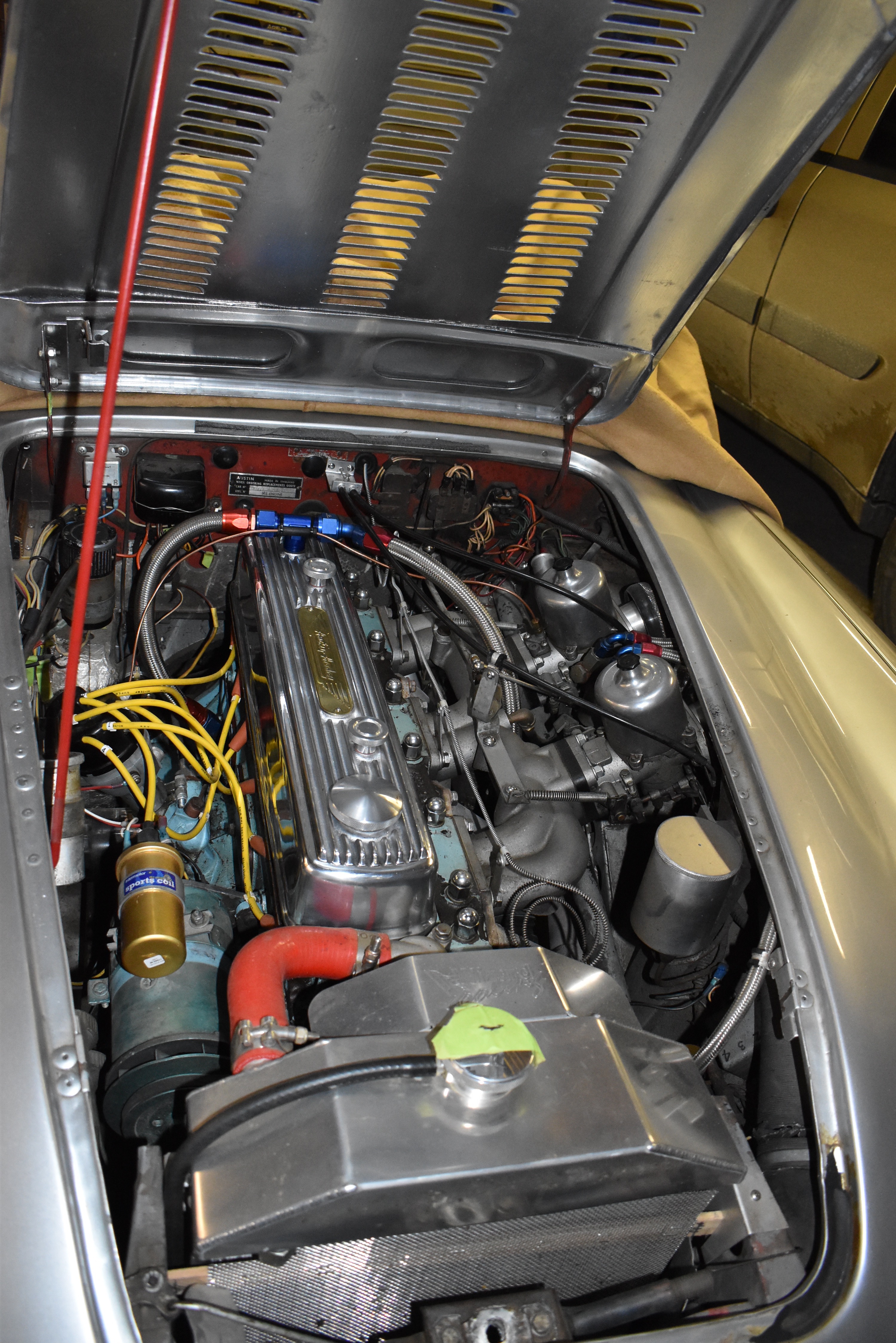

Hi Steve,
I haven't seen the RUDD Speed but I just got this one from "Healey Ray" in California.
He does beautiful work.
Good luck,
Peter

Is that your engine Peter? That looks great and I like the intake manifold. I'm familiar with the valve cover, my son has one on his BN6.... good looking piece!

Do I recognize the piston rods in that motor......?

Dougie, my engine has your nice rods!!!... not sure what Peter has in his.
