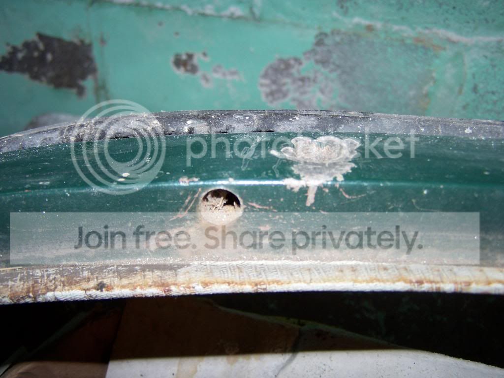

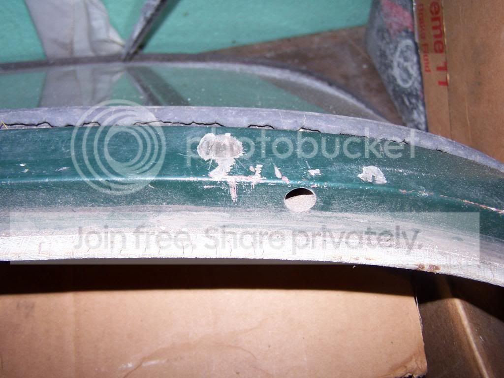

Doug,
Here are a couple of pictures of the holes from the frame in the worst condition. The one in better shape is up on a top shelf to keep it out of harms way and not really accessible at the moment.
My quick measurements are that the holes appear to be 1" on center apart from the top holes and just short of 5/8" to center from the top edge of the frame. I'm sorry but I forgot to measure the size of the hole. :frown:
These were quick measurements with a tape so please just use them for comparison with someone elses! I can go back this weekend and try and do a better job if you tell me where you would like me to measure from.

Doug,
Please wait for someone else to post some similar measurements as you should have a second (or third even!) opinion before you go drilling holes in an original Surrey top backlight frame based on my measurements with a tape measure!
I did take some more measurements this evening that hopefully Randy or Bob (new Surrey top owner!) can corroborate.
Top hole diameter: 7/16" (note this appears to have elongated front to back)
Soft top frame hole diameter: 7/16"
Soft top frame hole depth: 1 1/4" (deeper than I expected!)
Top hole to soft top frame hole (center to center): 1"
Top hole to soft top frame hole (edge to edge): 9/16"
Soft top frame hole to soft top frame hole straight across (edge to edge): 27 3/8"
Note that the top of the soft top frame hole is very close to the edge - around 1/16"! I'm not sure how you would be able to accurately judge the vertical angle to drill the hole and insure that you don't come out the top of the backlight frame especially if you make them as deep as mine are since the backlight slopes downward. It was hard for me to gauge the horizontal angle as well but hopefully you could tell that from the actual frame.
I wonder if they just filled them in with something softer than the aluminum frame (bondo?) that could be dug out without drilling other than perhaps a small exploratory hole?
Scott

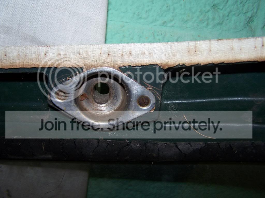

The plot thickens.
I don't know why I didn't think of this before. I pulled off the weather stripping and just pealed back the head liner from the front edge of the backlight frame to see where the holes had been filled in. Well, there are no holes that I can see. So much for that plan. I'll throw a pic up in a few minutes.

Doug, some funky characters in your link I think
ok, think I've got this flicker thing figured out. My previous post should have the images in it now.
Doug,
Those shots appears to be taken from the underside of the backlight frame and not the front face of the frame. The holes for the soft top frame are not open all the way through. They are closed which is why Mark and I gave you the depths from our frames.
It would appear the hole for the soft top frame would be drilled through that rib you see. Is that a screw hole in the rib for the chrome piece as well? I've not investigated that part of mine yet.
Scott
Hey Scott,
Those shots are from the underside of the frame.
I think you're right the hole for the HFrame seems like it would be inside that rib. I've inspected the front of the frame to try and determine where they are filled in, but the paint is completely smooth and I can't tell where it was filled in. I guess I'll take the measurements you guys gave me and drill an exploratory hole to see.
That small screw hole is for the chrome piece to attach to.

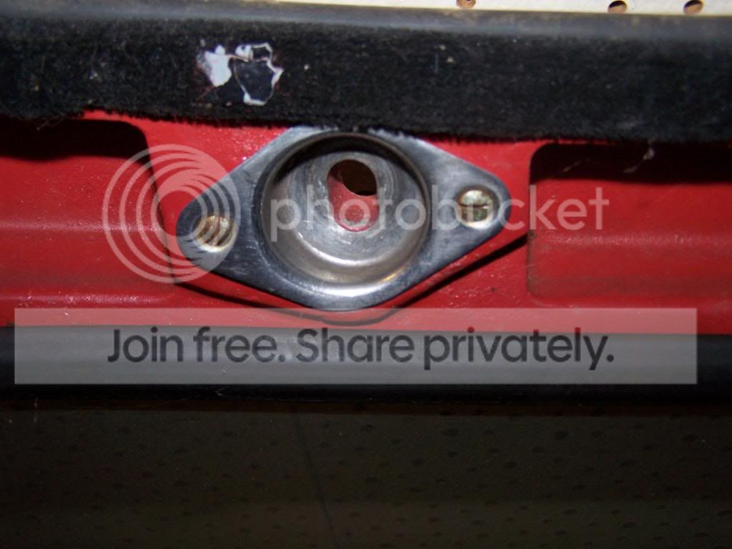

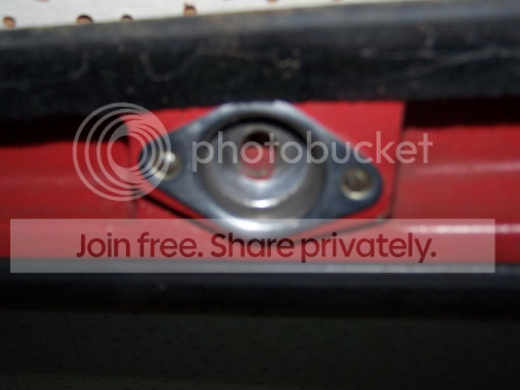

Doug,
Here are some shots of the bottom side of mine
Driver's side:
Passenger's side:
Passenger's side:
Driver's side (sorry this one is out of focus):
