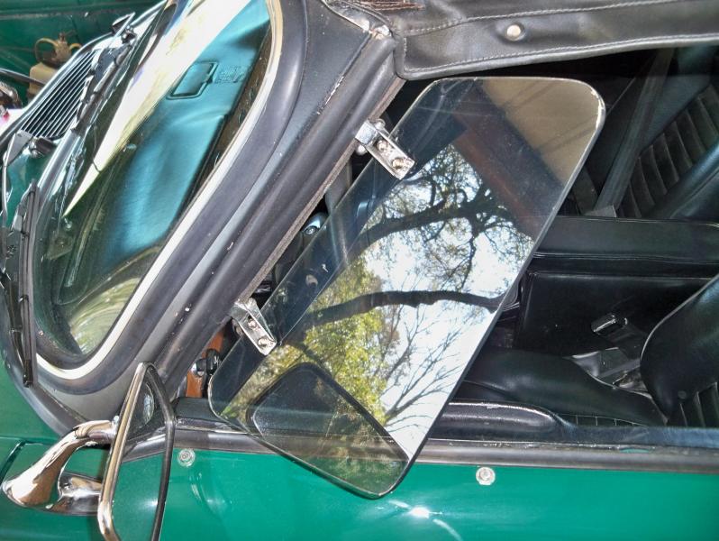

I added flaps. When I roll up the windows, the glass is sandwiched between the original flap and the longer one I added.
I don't have a picture that really illustrates what I described and the cloth surrey section is off and put away until Winter but maybe you'll get an idea from this. Wind Wings...new 001.jpg
