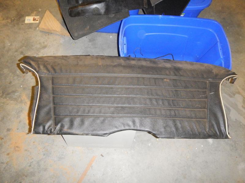

P.O. has customized rear seat. Upper area bent over as in a package shelf and extended to the sides to inner quarters. I want to OE configuration with a rectangular back rest.
what I have not found out is how to support the this. I can build a plywood panel and fabricate a back rest cushion.
P.S. roll bar has bee removed already.
Hello Jayplum

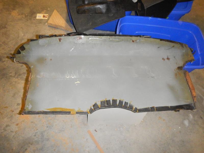

This is a photo of the rear seat back that came with my TR3A. I did not use it as I got the complete interior kit from Skinner. The kit includes the covered seat back.If you need photos of the seat bottom I have some.
The back attaches along the top edge with screws and 2 small brackets at the bottom.
David
Thanks that is the piece I will need to fabricate
Does the actual seat back rest attach to this panel and the bottom as well?
There were different patterns at various times; but that's all the back the "rear seat" had. Just some thin padding over a metal or wood sheet.
