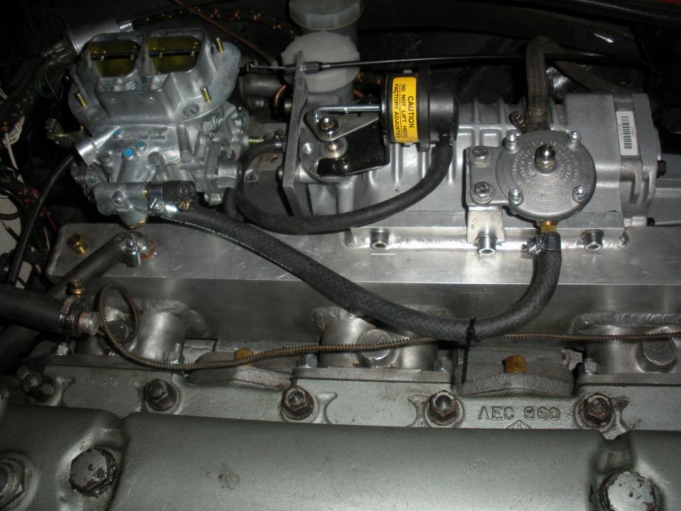

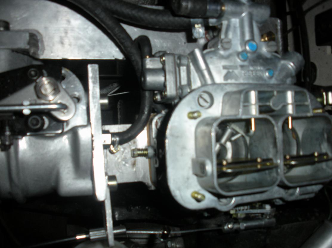

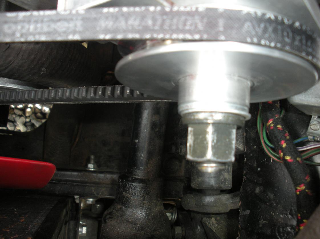

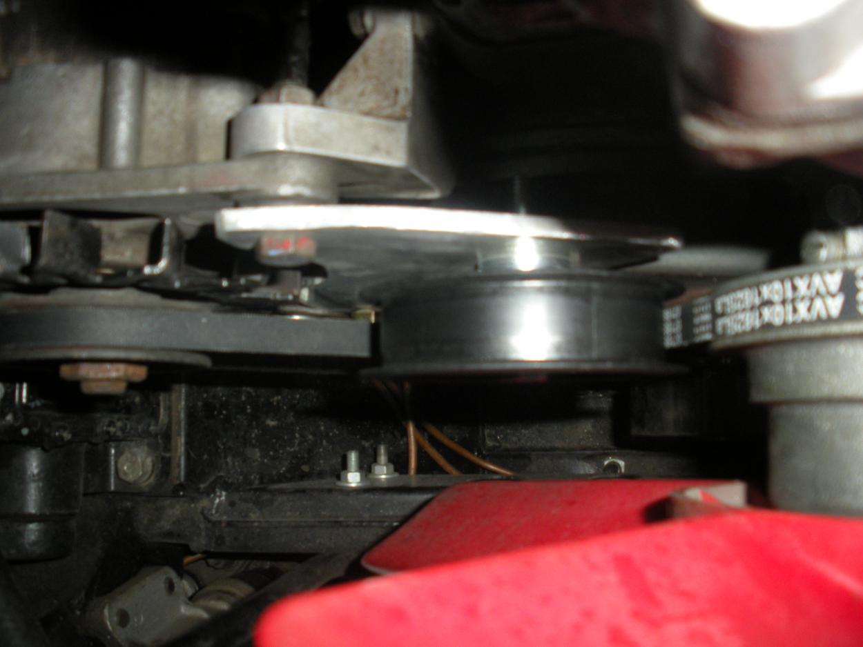

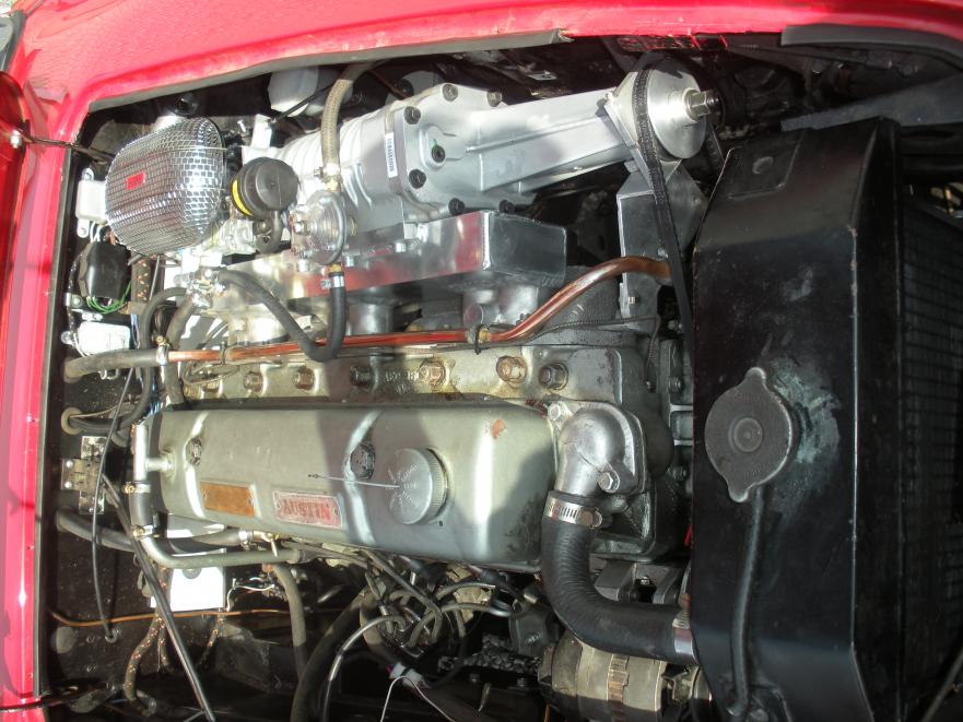

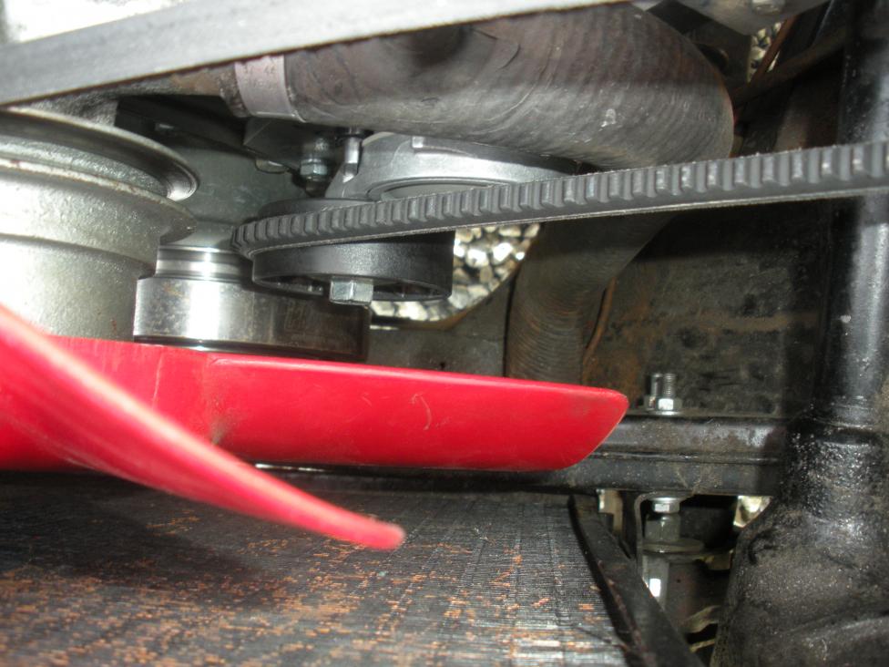

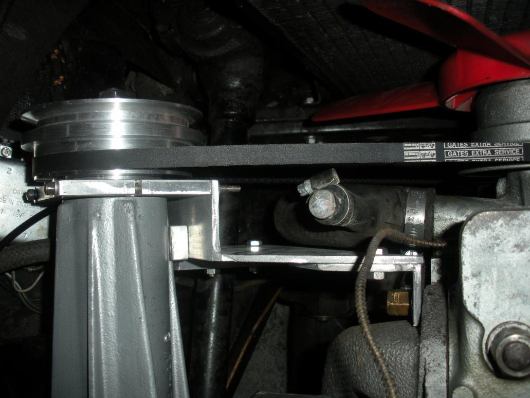

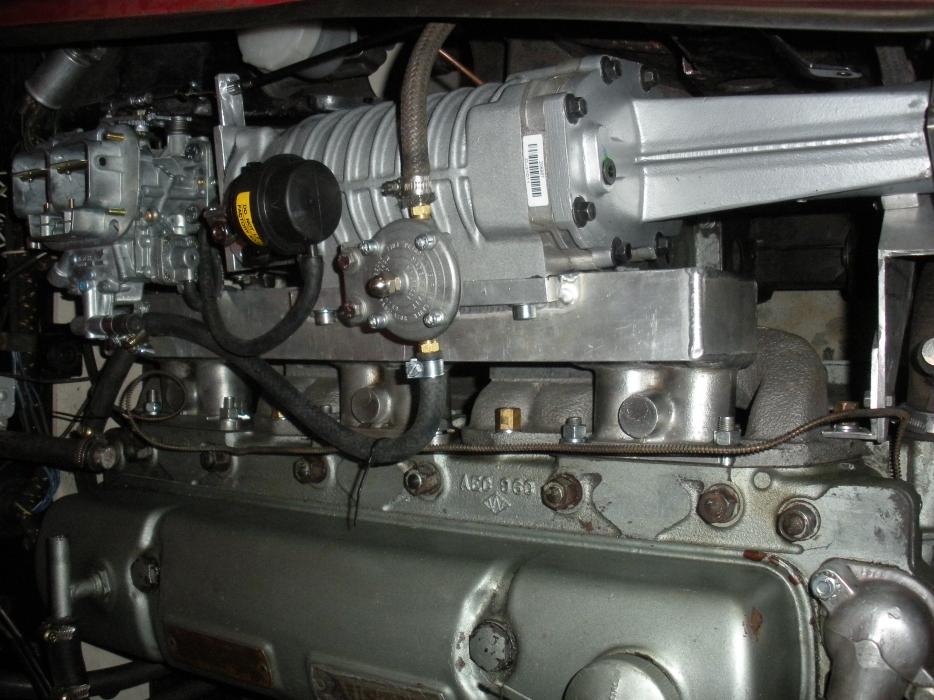

Randy, thanks for your comments on airfilter and tensioner pulley. Yes, that flat air filter (in my case for the weber 38/38) I have seen it on the web, but 1 3/4" thick will be too high. 1 inch at the max may be could work. I have also been thinking and looking for a tensioner pulley to put eighter before (pushing down the belt)or after (pushing up the belt) the supercharger for a better grip. But I am looking for the most "compact" tensioner available because, again, space, space, space. Also the base (that bracket holding the nose of the charger) on which I can fix the pulley is 50 mm away from the center of the belt. Have you an idea ?
