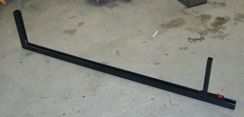

I'm a bit confused by your description of your problem. You say that you can visually see that the tires are "toed in" and that the tie rod end was screwed on to the same place as originally to maintain the alignment? First, it's almost impossible to "see" the recommened 1/8" of toe in. The difference is so small most can't detect that amount visually. You need to check it with some type of reference gauge, either string the car or make up a toe gauge that you can use under the car on the front and rear of the front tires. You need to check the measurment of the tread width at axle height on the front and rear edge of the tire and that should be 1/8" wider at the rear than the front. Get that sorted first if you can then you can check the camber. They are a bit inter related so as you turn the tire it will start to change camber as well, so get the tires straight and toed in properly before checking camber. If you find that the camber is off then shim or replace bushings and then reset the toe in. If you don't know how to "string" the car to check alignment then I suggest using a simple toe gauge that you can easily make from some scrap 2X4s. All you need is a wide "U" shaped piece that will span the front suspension from outside to outside. Just place one upright against the edge of the tire tread and measure from the other upright to the edge of the tire tread on the other side, then repeat at the other side of the tire and compare the measuremnets. The "U" shape allows it to rest under the car clear of the chassis. Here's a gauge I made for my shop from some scrap metal I had around to get an idea.
