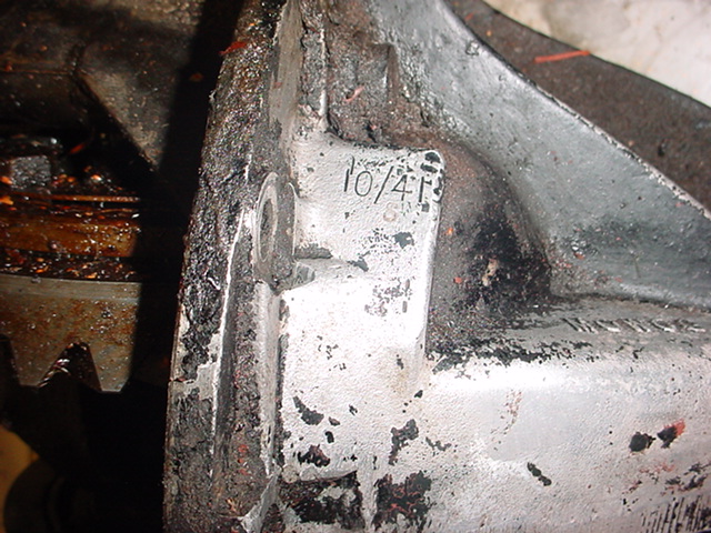

Art, On the top side of the aluminum gear housing there is a flat spot that has a number stamped in it. for a 354 gear the number will be 39/11 this is number of teeth on ring and pinion gears
39 divided by 11 = 3.54 Bob

The marking can be hard to find. Usually under dirt or paint. Here is a pic of a housing that is stamped 10/41, or 4.11 ratio. On a flat spot near the top & slightly to the outboard side. Other housings may look slightly different.
D

If you can't locate the numbers you could set the car on jack stands and mark the rear wheels and the drive shaft with chaulk. Turn the drive shaft 3.5 times and see if you get 1 complete turn on the rear wheel. if so it a 3.54 If it takes a tick over 4 you most likely around 4.10 or a tick under 4 probably a 3.90. I haven't tried this but I think it should work???
