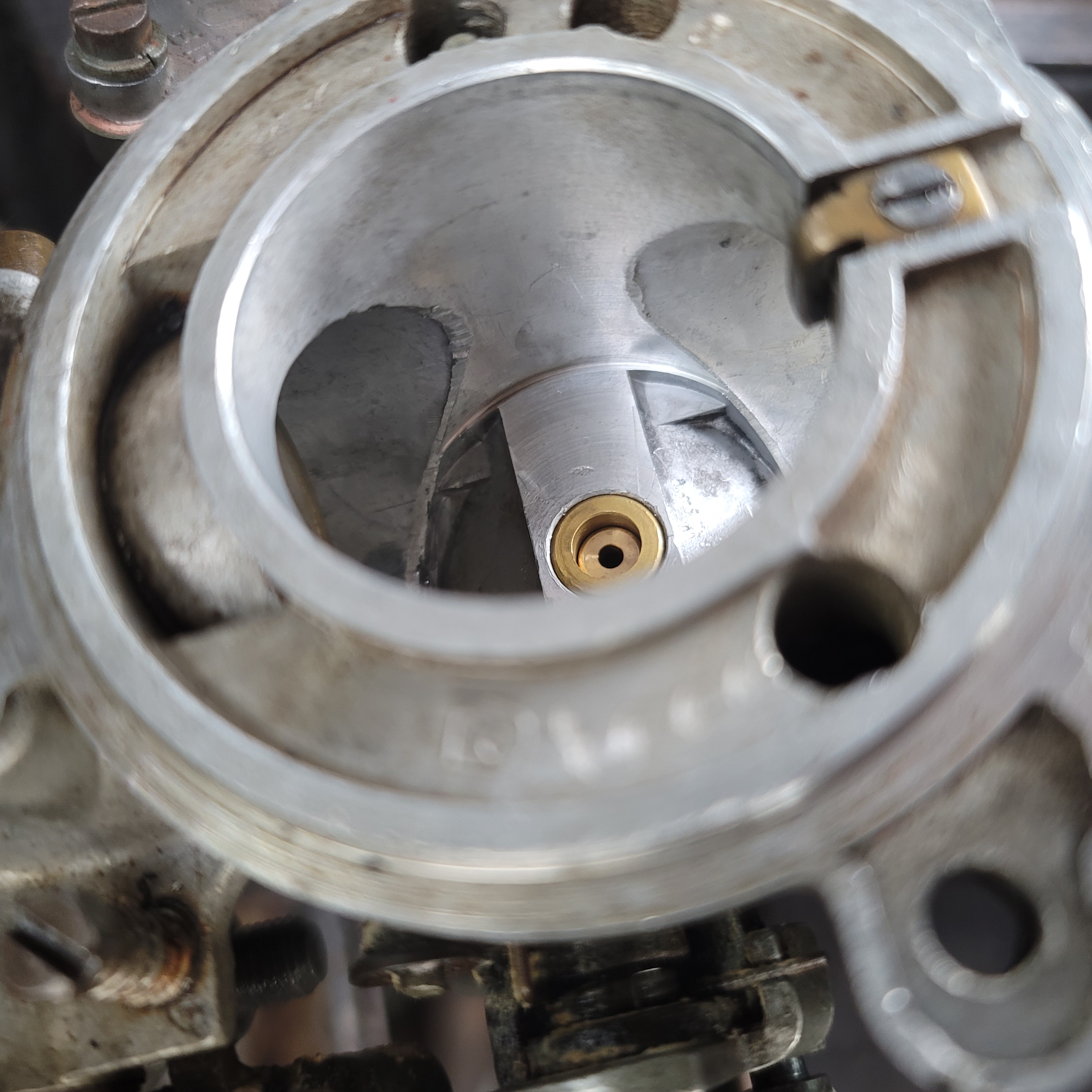

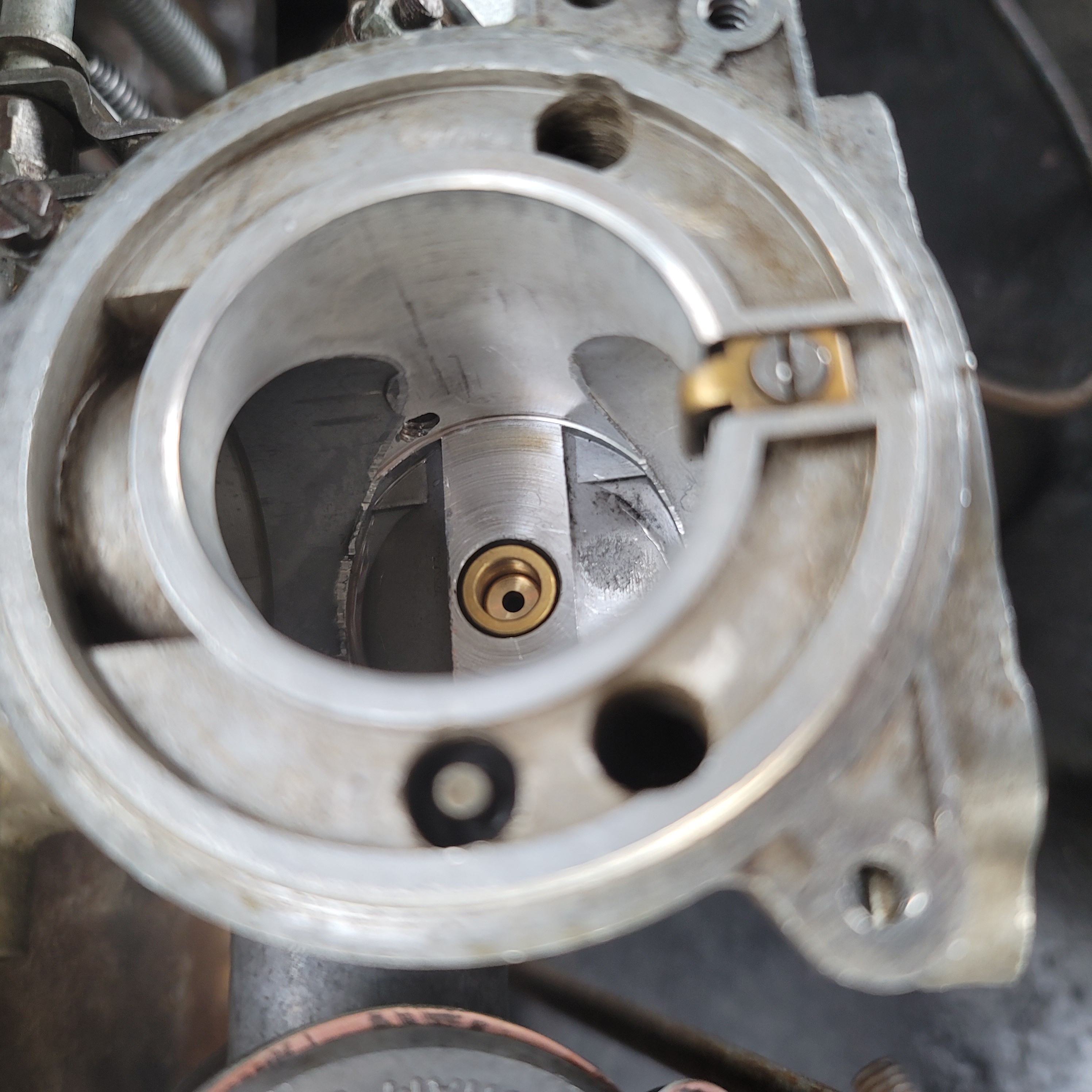

I read somewhere that the top of your jet should be flush with the bridge. Is this true, and if so, is this causing any major running issues?
