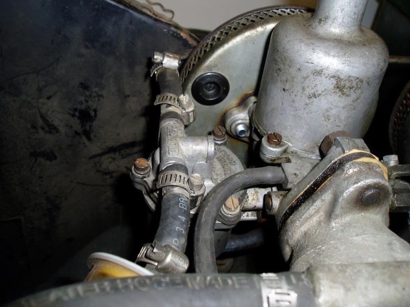

That is consistent with the tin SUs on my Herald although I think mine are HS4s. (I can't get to them until I move the car out of storage) but they do have 5/16 NC 18 bolts. Mine are shorter because the bolts only hold the bases of the air cleaners to the carb bodies. The bolts that hold the bases on screw into threads on the carb bodies.The covers and elements come off with the bases still bolted on.
Here's a picture from the backside.

Thanks for the info. Most appreciated. My challenge appears to be that the air cleaners I purchased have a metric screw thread in the plates that then get attached to the carbs. The carbs do appear to take the 5/16th UNC bolt as you all have suggested. Now to figure out a solution to the differing screw threads between the air cleaner plates and the carbs. Ah the joy and challenge of getting this Herald once again road worthy.
TomMull
Gents,
If the plates have screws/bolts attached, then they must be designes to be intended to have nuts rather than to thread into the carb bodies. Can you get the attached screws out and replace with 5.16 18? If not you could drill out the carbs; not a good idea and not much room for nuts there anyway. How attached to those air cleaners are you?
