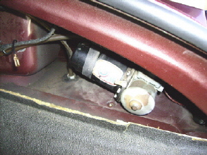

well I finally got to exploring one of the SU pumps in my S type today.
And what do I find?
A "BMC Factory Approved Rebuilt" pump. I tried to get the picture to show the BMC sticker but nooo, it doesn't want to be photographed.
BMC is/was British Motors Corporation, correct?
I also noticed it was leaking!! so I removed the whole thing and tightened all the screws and banjo fittings. No more leaks.
(this may have been the result of the car sitting for 1 whole year with little gasoline in the tanks).
No dates anywhere, no pun intended.

Ex's pump was likely replaced at a dealership. Great news that th' leak was stemmed with a bit o' torque, too!

Can you tell where the leak is occurring on the pump? If it's at the diaphragm joint for sure, you may be seeing the effect of alcohol/ethanol fuel 'additive'. The stuff is unkind to older rubber bits.
BMC ceased to exist in about 1967~8... "BLMC" is what it became. Most dealers had stock on their shelves, so may be hard to pin down just when that pump went in.
