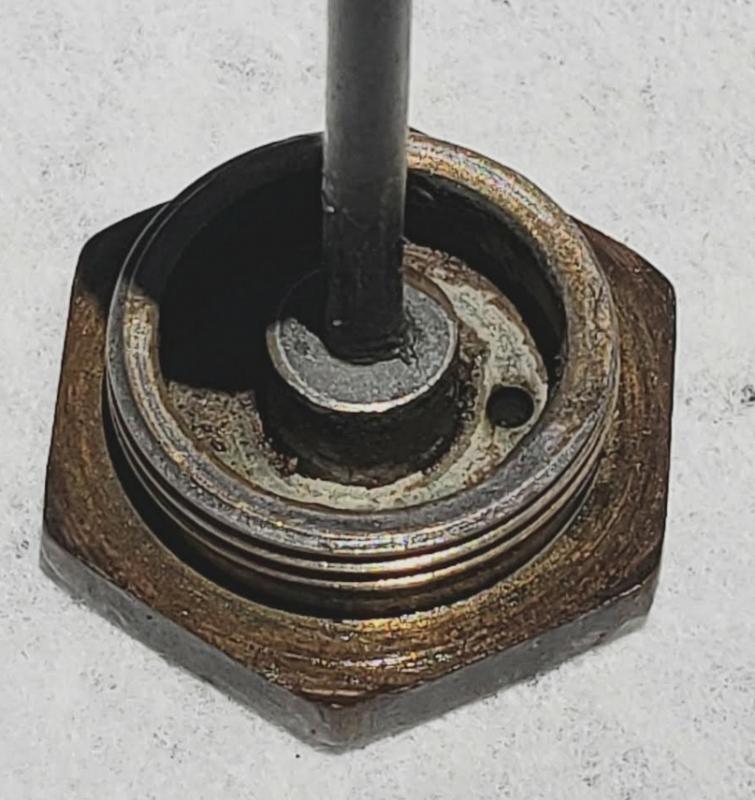

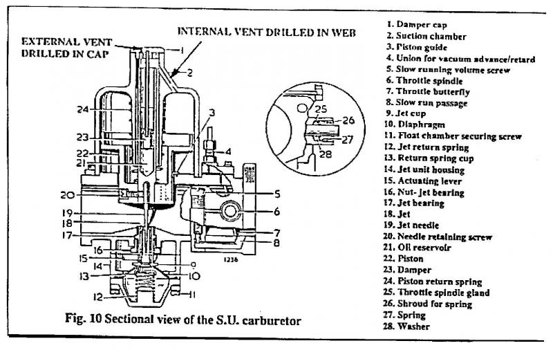

*plastic is cheaper; brass is stronger - plastic caps have been known to blow out in a backfire (unlikely).

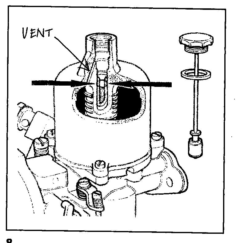

**non-vented caps go with carbs that have a little hole drilled per this. Vented caps don't have the little angled hole. You must have one or the other.

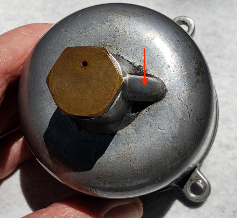

Where is that hole? I can't tell exactly where the arrow you drew is pointing to. (The other two arrows are pointing to the piston oil fill level.)
Should the hole be on the flanged part of the neck?
If there is no hole, I think it would be best to drill a 1/16" hole in the cap.
It's my friends HD6 carb and I didn't see any holes. His brass cap is non vented and he tells me these are the original carbs with original brass caps. But, he's not the original owner, so there's that.
steveg
I read about that in an article by Jim Taylor.
Sorry, should have circled the slanted hole my arrow is just touching. Ignore the two big arrows. If you don't see it, it's not there. You could also take the dome off and see it from the bottom, if it's there.
My original HD6's have the vented brass cap and no slant-drilled hole. Will upload pix later today.

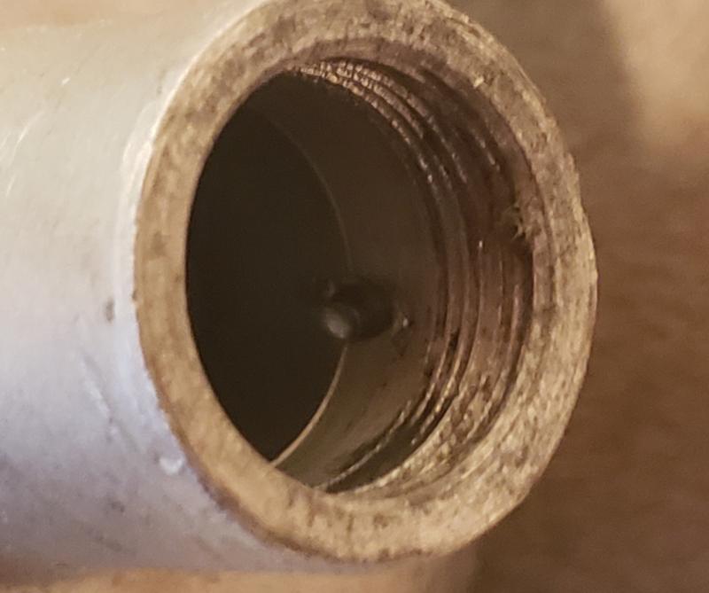

The hole is not visible on the outside of the dome I'll assume. The tube the hole makes is from the inside of the neck to the bottom of the dome?
steveg
Correct. Here's a better dwg:
1/16" hole as measured with drill bit
If hole were present would be directly above, or at, the bright lower ring
Hole would show in circled area - in the area of the sharpie mark at the 3 o'clock position

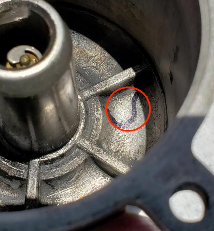

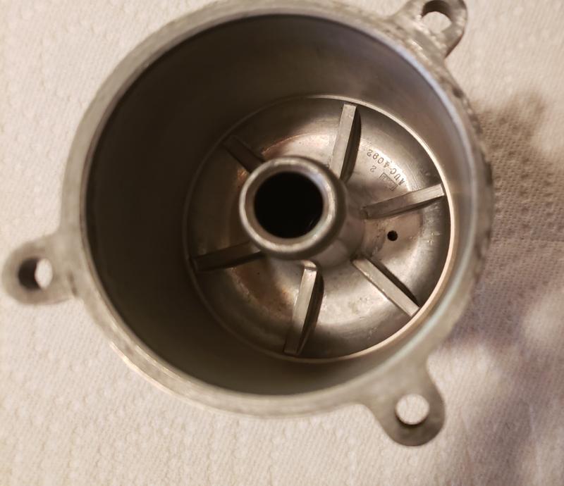

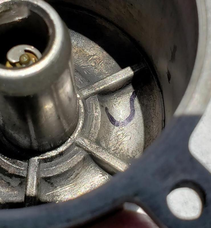

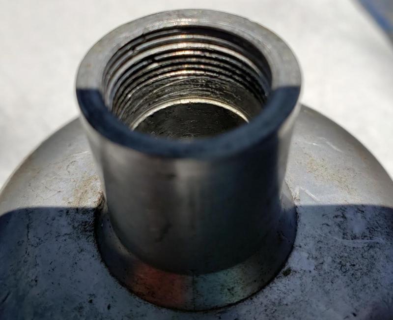

I'm certainly confused. I asked, The hole is not visible on the outside of the dome I'll assume. You replied correct.
Is this the circled area?
steveg
View attachment 64145View attachment 64146
The circled area is on the right-hand picture. Referring to the drawing above, that is where the hole, if there were a hole, would appear. The circle I drew aligns with the "web" visible in the left-hand picture and the drawing above. My HD6's came with the hole in the cap, not the internal one. Only one hole is necessary.
If your friend's HD6's don't have the slanted internal holes, they'll need holes drilled in the caps.
