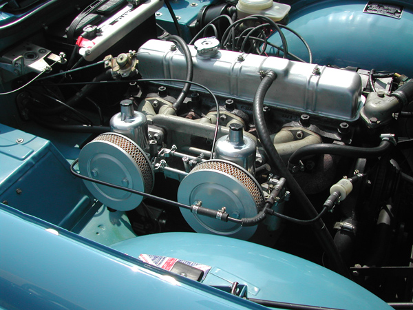

just got a pair of hs6 carbs but am alittle confused on how to set up the linkage and the fuel lines on the top of the carbs there are a number of fuel outlets anyone have any pics it would help alot and also how to set up the choke cables

good tech stuff but i need real pics to see whats going on the carbs that i got have the float bowls and the linkage connections on the inside facing eachother

Here's a TR6 with SUs I saw at VTR 2004. I din't know anyhing about putting SUs on a TR6.

NO pics here, but I have been considering the conversion myself.
This is what "I think I know". The fuel comes into the float chamber with 2 nipples. Enters one nipple then splits off and exits via the other nipple to the 2nd carb's float chamber.
You MAY also have 2 vacuum ports with similar size nipples that are for the valve cover ventillation hose connection. These are on the carb body proper.
They are Spits but Spitfire and GT6 magazine Photo Pages has several pics of dual SU setups. Go to the "slightly modified" section. Rimmer Bros. probably has the stock linkage setup for dual SU's
