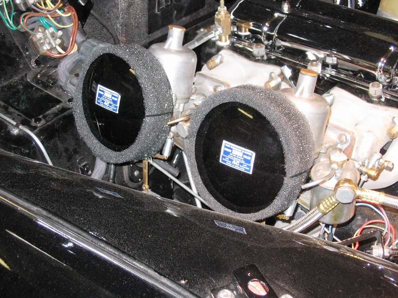

Look at what I did for my TR3A. I went to Sears and bought a foam filter for an industrial vacuum cleanrer and cut off two sections to fit over my air filters. Then I soaked some "AMS Oil for Foam Filters" over the foam.
It only takes a second to remove them before the VTR or TRA judges arrive.
