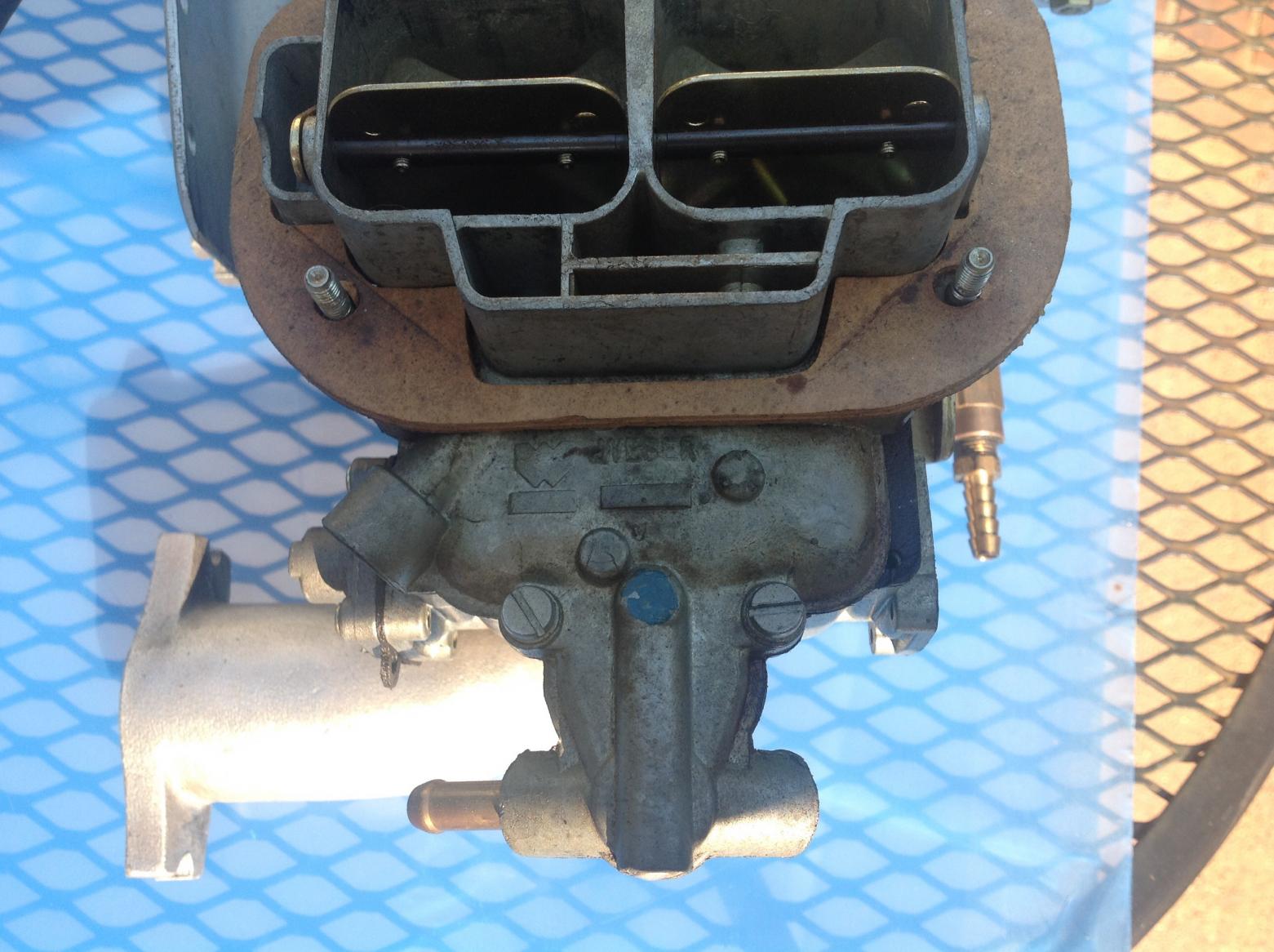

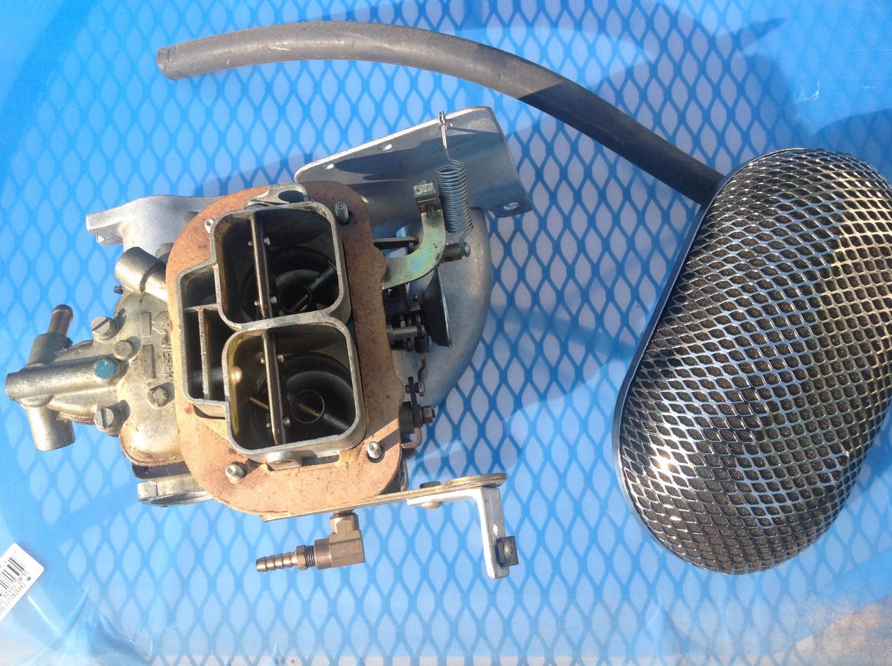

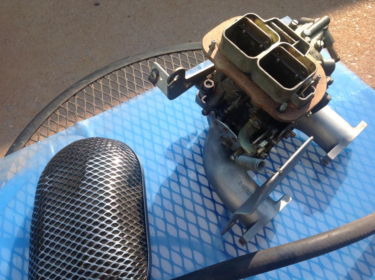

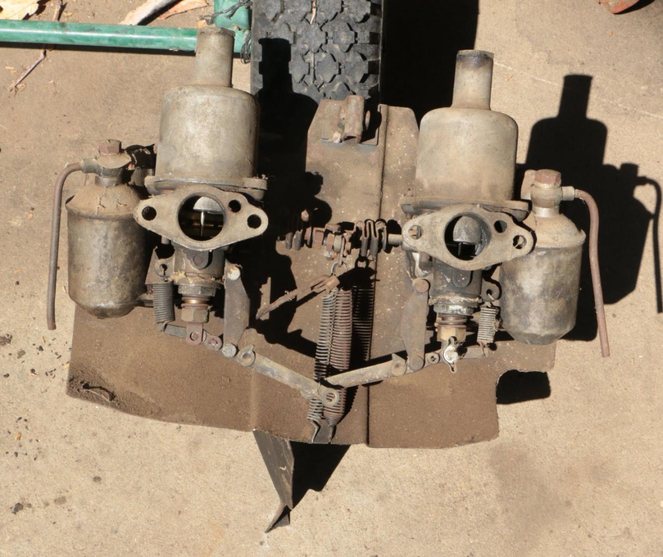

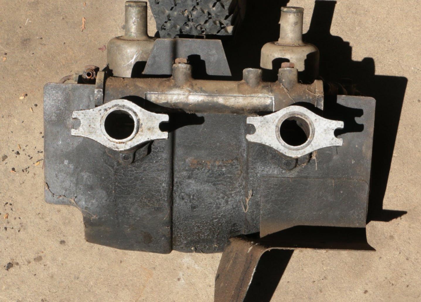

Thought this might help illustrate some of this conversation
