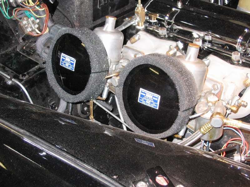

I had several TR owners advise me to install a heat sheild back in 2007 when I was getting a lot of stalling, stuttering and lack of fuel flow to my carbs on hot summer days - such as when I drove 1550 miles round trip to VTR in Valley Forge PA. I assumed (as did many others) that this problem was caused by vapour lock resulting from the 10% ethanol added to gasoline in USA. I later changed out a 51-year old rubber hose feeding the float bowls and I was told to add 4 oz. of Marvel Mystery Oil to the gas tank every time I fill it up. I have done this and all the fuel issues have been resolved. Sice then, I have driven over 7,000 miles.
