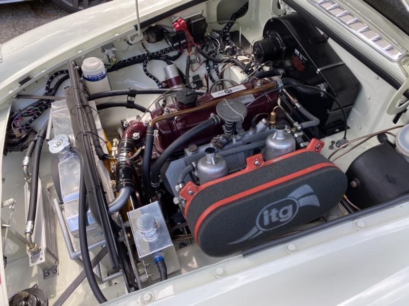

I am not a fan of any foam based air cleaners, as they are a fire risk.

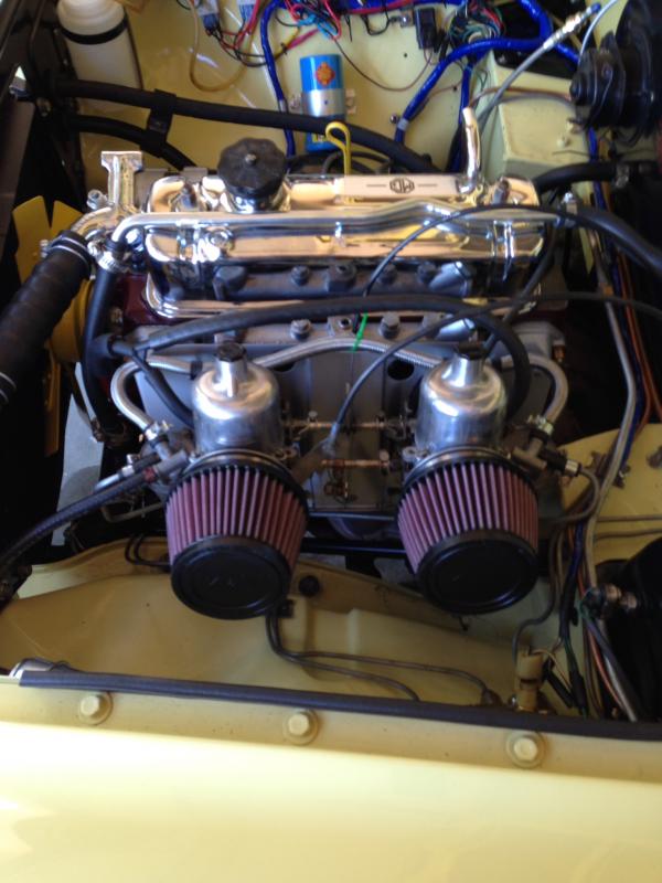

On E-Bay, a guy named BB Bullock (selling as namvet6970) sells nice velocity stacks for the SU HS6 carbs, but they also work with the SU H6 carbs. The air filters are K & N RU4410. It is a sweet set up.

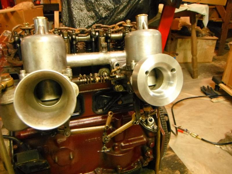

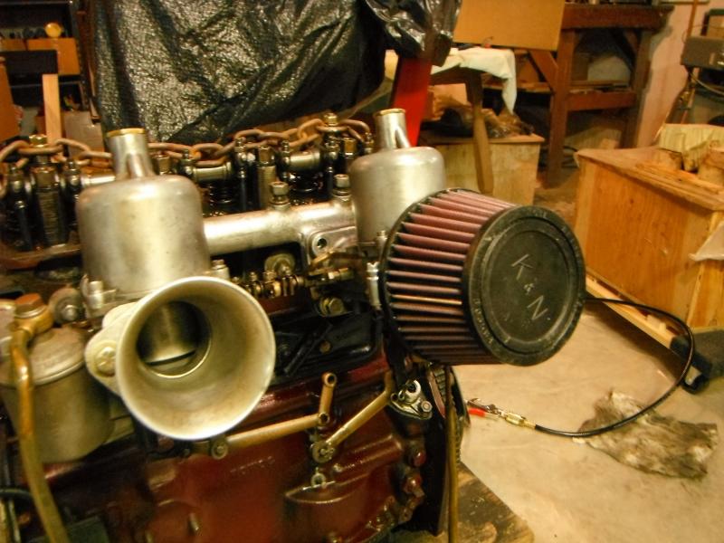

In these pictures it is the set up on the right. Here I was converting over my engine to this setup.
