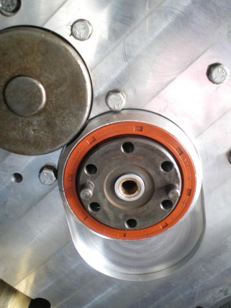

The cover is basically a can that covers the oil pump. It has a flange that gets sandwiched between the rear mounting plate and the block, seen here in the upper left hand corner of the engine, as seen from the rear.
See Fred's post for the pic of the same area with the cover missing.
