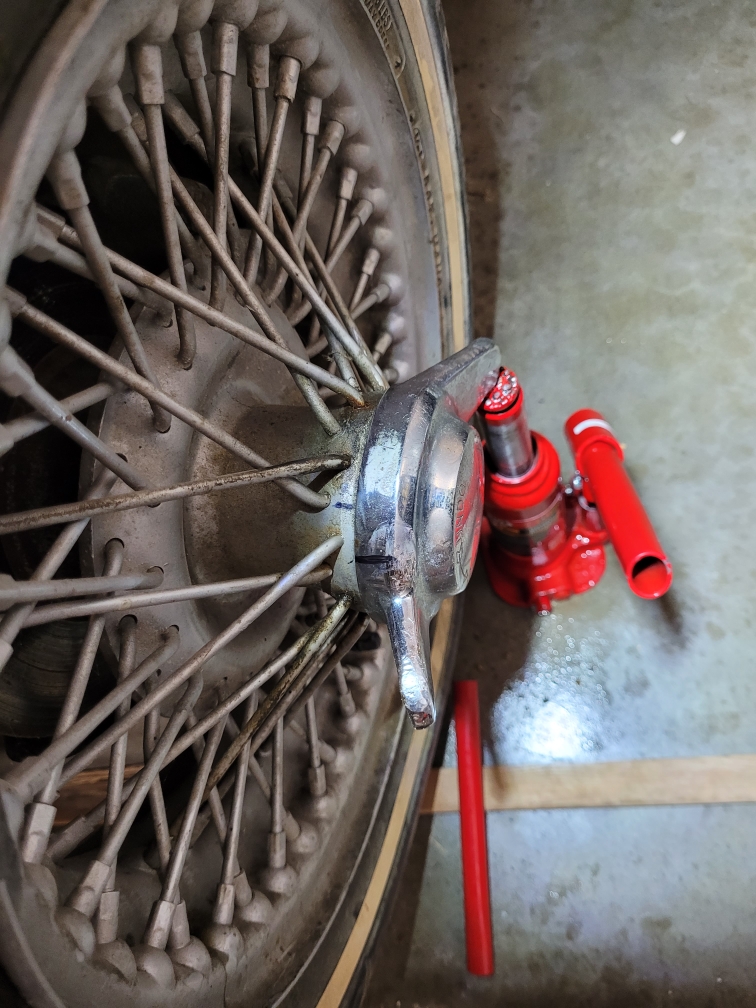

I got my STUBBORN 2-eared spinner off. Sharing a technique to hopefully help others
No cutting, no torch, no pnuematics. Attached picture is worth 1000 Words. I put a bottle jack on one end and used a soft blow hammer on the other. I made black marks with a Sharpie on the wheel and spinner to gauge my progress (it was painfully slow). At the progress marks below I gave it another 25 whacks and kept adjusting the bottle jack by 1/16 inch. On a whim, I tried my Clark and Clark wrench and it spun right off
This task seemed impossible a few days ago.
