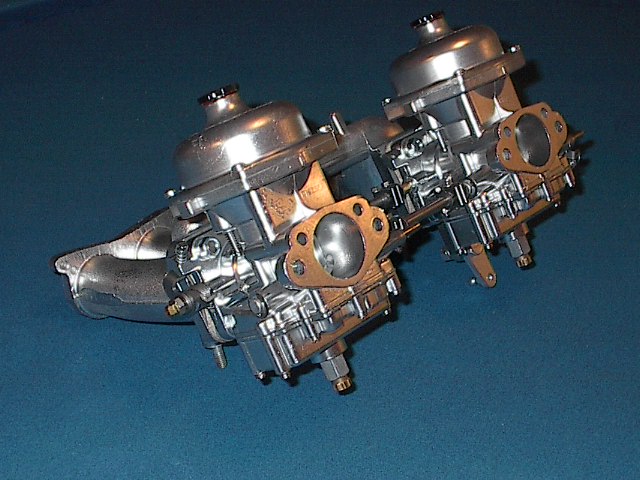

I am referring to the pre-emissions CD carbs, not the CD2. On the early ZS carbs the jet adjusts from below instead of adjusting the needle through the dashpot oil as on later cars. The early CD carbs have a jet that mounts in a jet bushing just like SU HS series carbs.
The picture below shows the jet adjusting screws on the bottom of the carbs. The large hex above/around the jet adjusting screw is tightened slowly as the jet is centered.

As Poolboy said, the TR4A carbs should be designated as 175CD. They will have the jet adjuster nuts on the bottom as can be seen in the picture I posted earlier.
The 175 series carbs used on other cars a few years later will not have the jet adjusting parts on the bottom. They are known as 175CDSE carbs.
