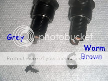

I'll go check the plugs and post a photo.

Wayne:
The plugs look pretty decent for a first attempt.
The front carb has grey plugs (lean I'm guessing)
The the rear carb has pale brown plugs ( pretty close ?)
Dale, backfire can be caused by a lean mixture as well as timing too far advanced.
Looks like you are well on your way to driving season.
Dale, give the no 2 side a 1/4 turn rich and you are about as close as it gets. Anti clockwise.
