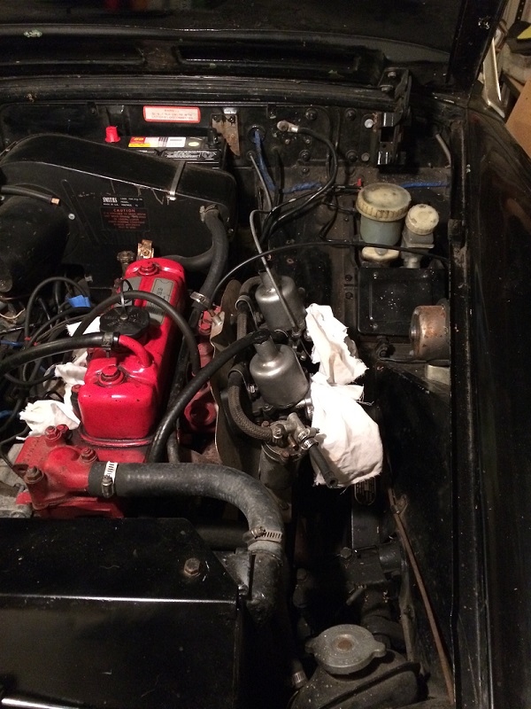

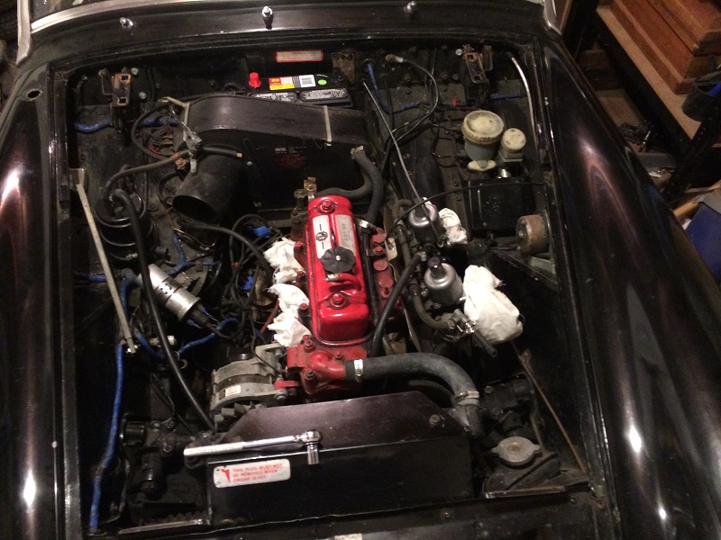

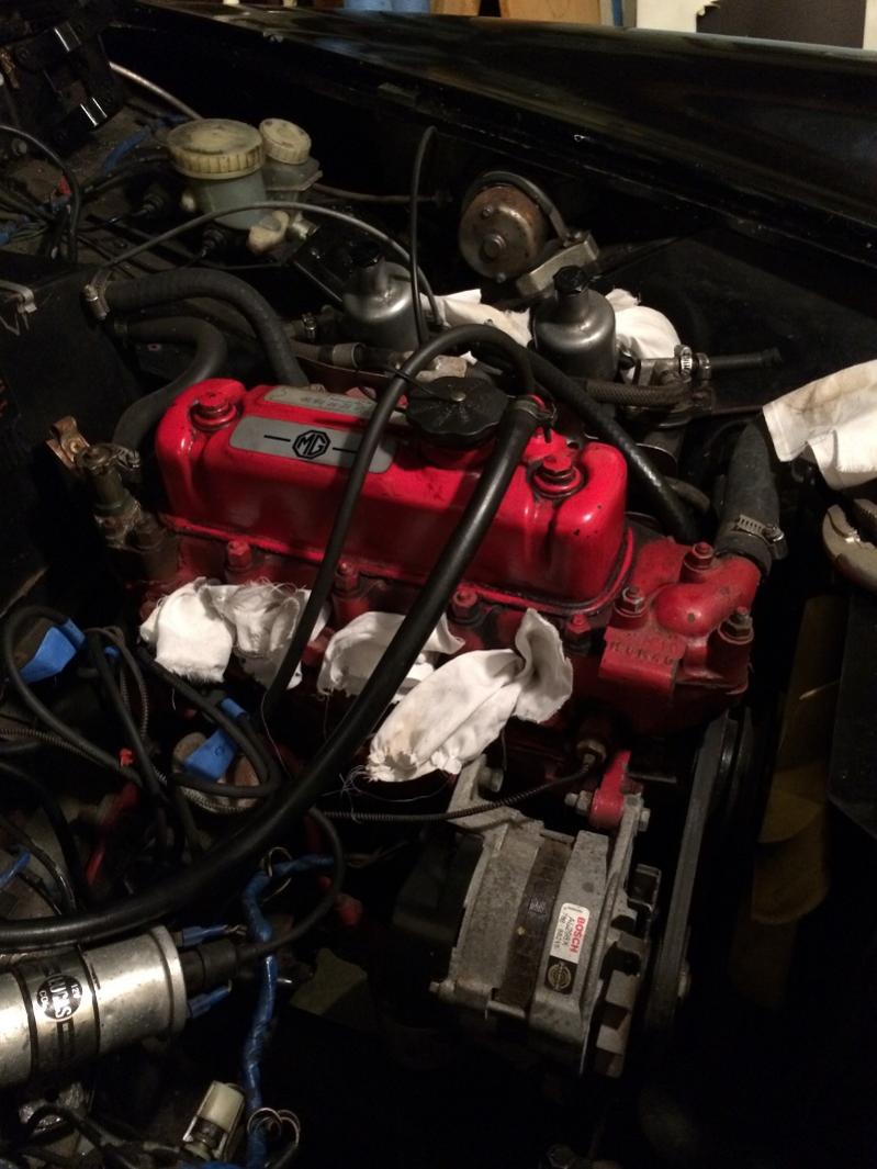

A few pictures to share, starting with some before pictures. Not BAD bad mind you, but pretty filthy, and the PO just loved to put paint on everything it seems...

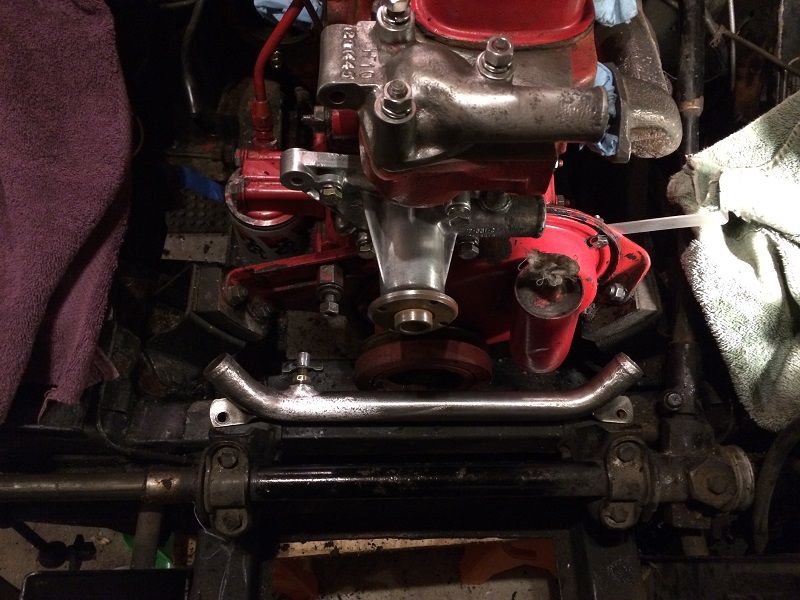

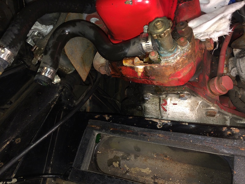

First up was the cheap thrills of wire brushing & sanding off the paint (and rust) on a few items. I definitely am liking that shiny look, and contemplating some POR15 clear coating on the thermostat housing, water pump and radiator lower tube. The intake manifold (not pictured) also got the works so it's also a candidate. For one thing, it's a lot easier to see stuff down there when it's shiny & contrasts with the black interior! New gaskets and stainless hardware for everything that I can as I go as well.

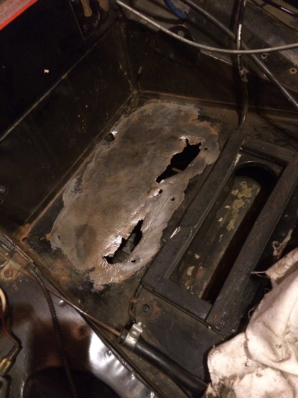

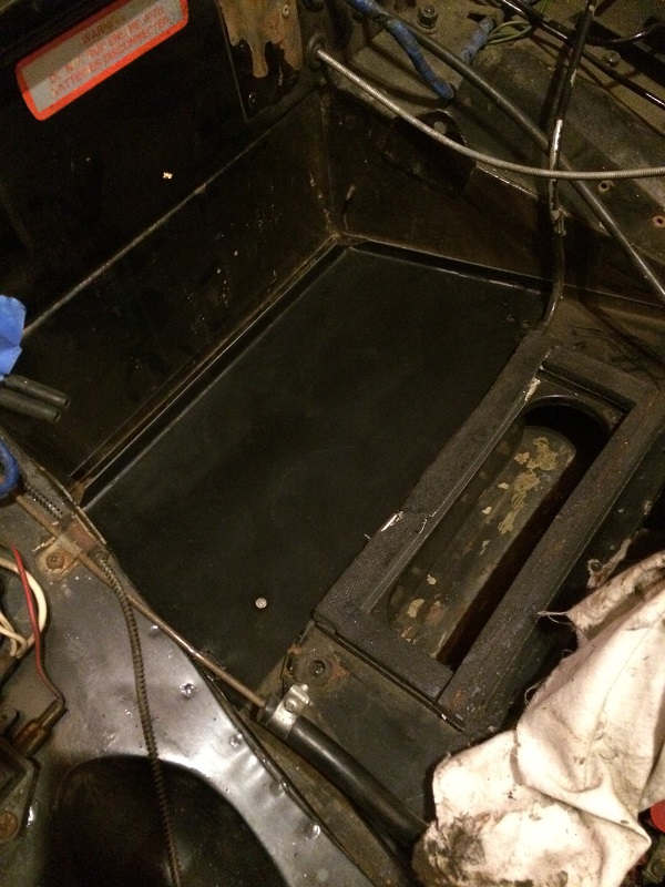

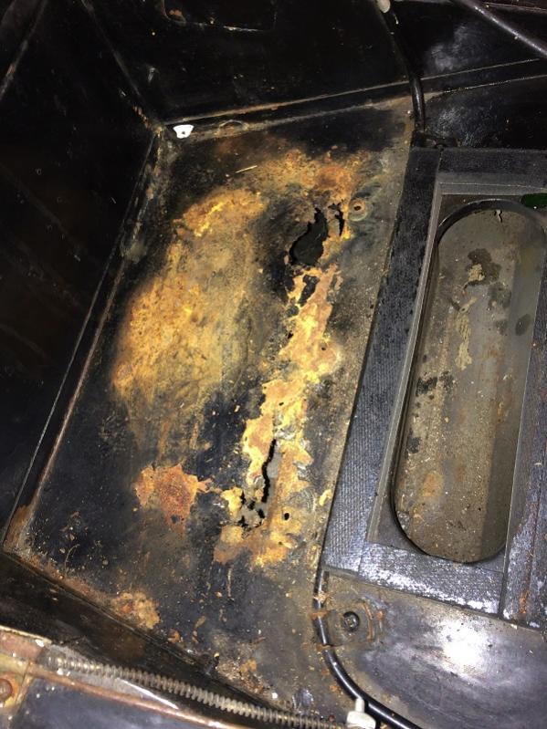

Also the battery tray needed some help. Not horrible, but still not perfect. Here's the sequence, including original, cleaned up, and a new replacement tray in place. I forgot to take a picture of it, but I put some pop rivets in to hold it in place.

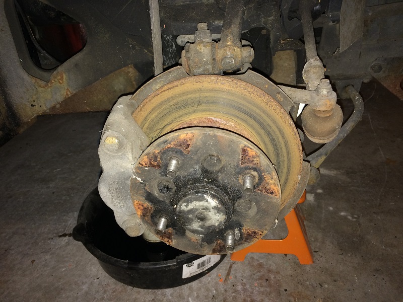

Here's what's coming up. I picked up both a front suspension rebuild kit as well as a front brake kit, so this will all be purdy some day...

Was the original color on a '74 1275 engine red as in your photos? For some reason I thought BMC engines were painted green. Just curious because I'll be picking up a '74 Midget soon.
Jeff
I'm not sure actually. This one was originally green, but got painted black at some point. It wasn't a great paint job, and no trim, etc. was removed first. You can lift up the rubber seals here and there and see the green underneath. Except for wires, most everything under the hood got painted black, and same for the engine. (all red).
