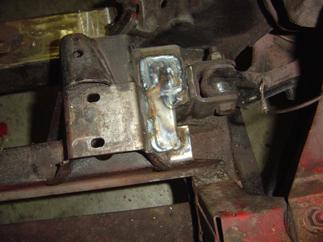

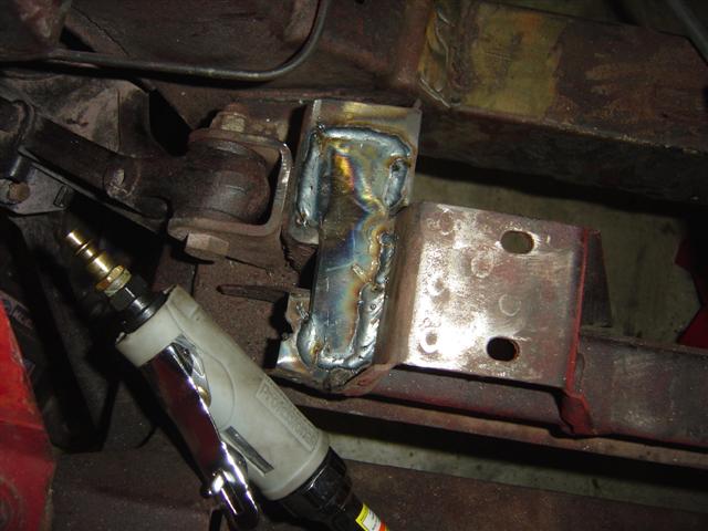

Steering rack to lower a mounts done, my welding needs a little practice but better than nothing
Hondo

Looks a lot like my welding (just starting to learn hehe). Proudly just call it Gorilla Welding! Big Strong Ugly! =p

alot of my problem is there is a lot of grease on the frame and in crevaces that I cannot clean out and once the metal heats up the grease starts flowing and the weld starts spatering, It tough to get all the grease out with out steam cleaning the front end and thats not happening so I got to figure anything is better than nothing at all
