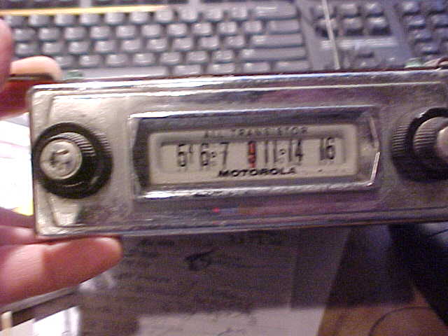

3. (be gentle) I haven't actually received the car yet to start taking it apart. My Dad has decided to give me his 64 Phase 1. Got it running, cleaned it up, just waiting to ship it down. He said "why wait 'till I'm dead". It's an AM/FM push-button radio with the bands marked "mC" and "kC".
The current photo I have shows no more detail than that.
4. WARNING: large photo, (dirt ALL GONE)

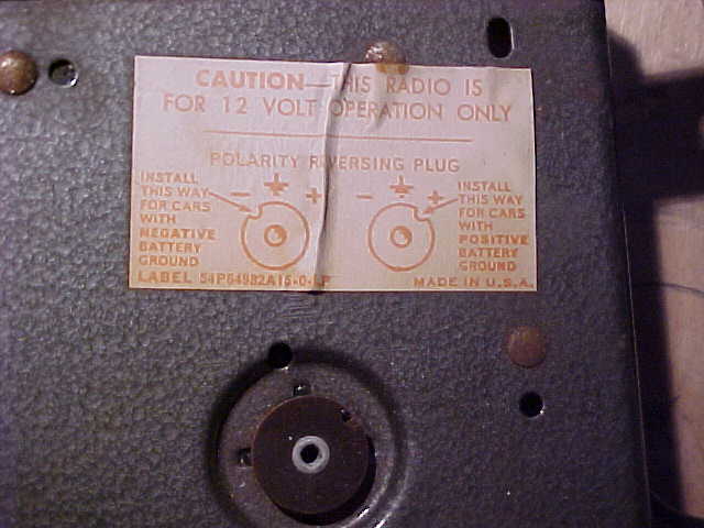

edkaler, heres a picture of the "polarity reversing plug" on my original a.m motorola .anyone needing this "historic" piece can p.m. me.

You do not want to just isolate the radio and run it as positive ground. This would leave the entire case of the radio "hot". If anything which is grounded touches the outside of the radio, you would have a interesting show. Based on how the radio was designed, you might also need to isolate the antennae base from the chassis.
Looking at your photo, I don't know that your radio is an original 1964 radio because of the FM bands. It is certainly a period radio from the later 60's. The MC and KC (megacycles and kilocycles) usage went out of style in the electronics industry in the late 60's (I think). What this comes down to is the radio was probably desinged as a radio which could go both ways. It should be easy to convert it from positive ground to negative ground.
I would locate a (old) radio (fixer/restorer) guy and ask about having it converted. Get the model number. He will be able to tell you. He should have schematics.
Mark
