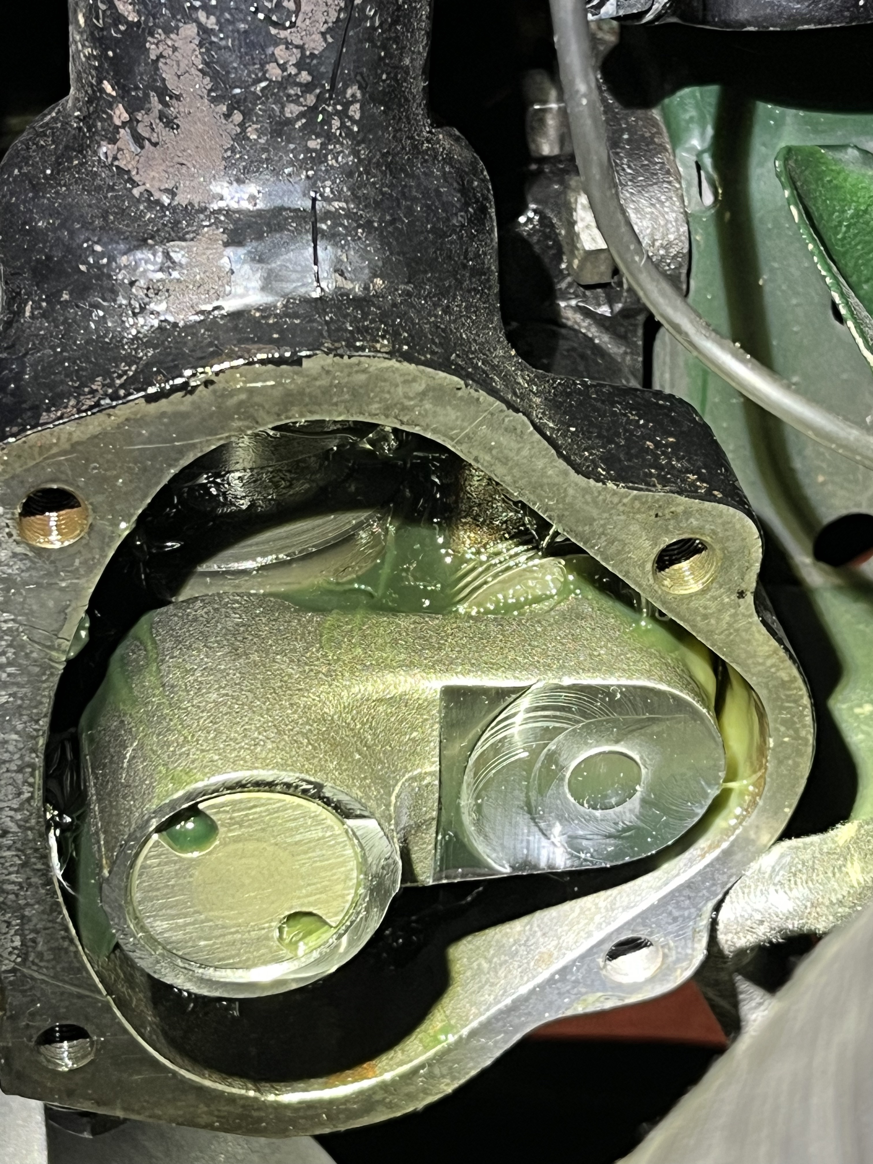

Richard, thanks. That is new to me. I was aware of the belleville washers, but didn't really understand their function. It sounds like the peg should never be in the bottom of the worm gear groove (?), so if I open the lid and find that it is, I guess this would be an indicator that the washers are installed incorrectly. Here is a photo I took the first time I opened the box and removed most of the grease. If I understand things correctly, the stack of washers is visible, although it's unclear from this shot how many there are and if they are installed correctly.

From what I can see it looks like the washers are properly stacked. But yes, the peg should never bottom out in the groove.
I'm surprised a new box from AHS would come packed with grease. DWM sends a can of Miller's with theirs. Grease is usually used--at least by me--only to stop a major leak from the box (many discussions on this forum; JD Corn Head Grease seems to be preferred).
