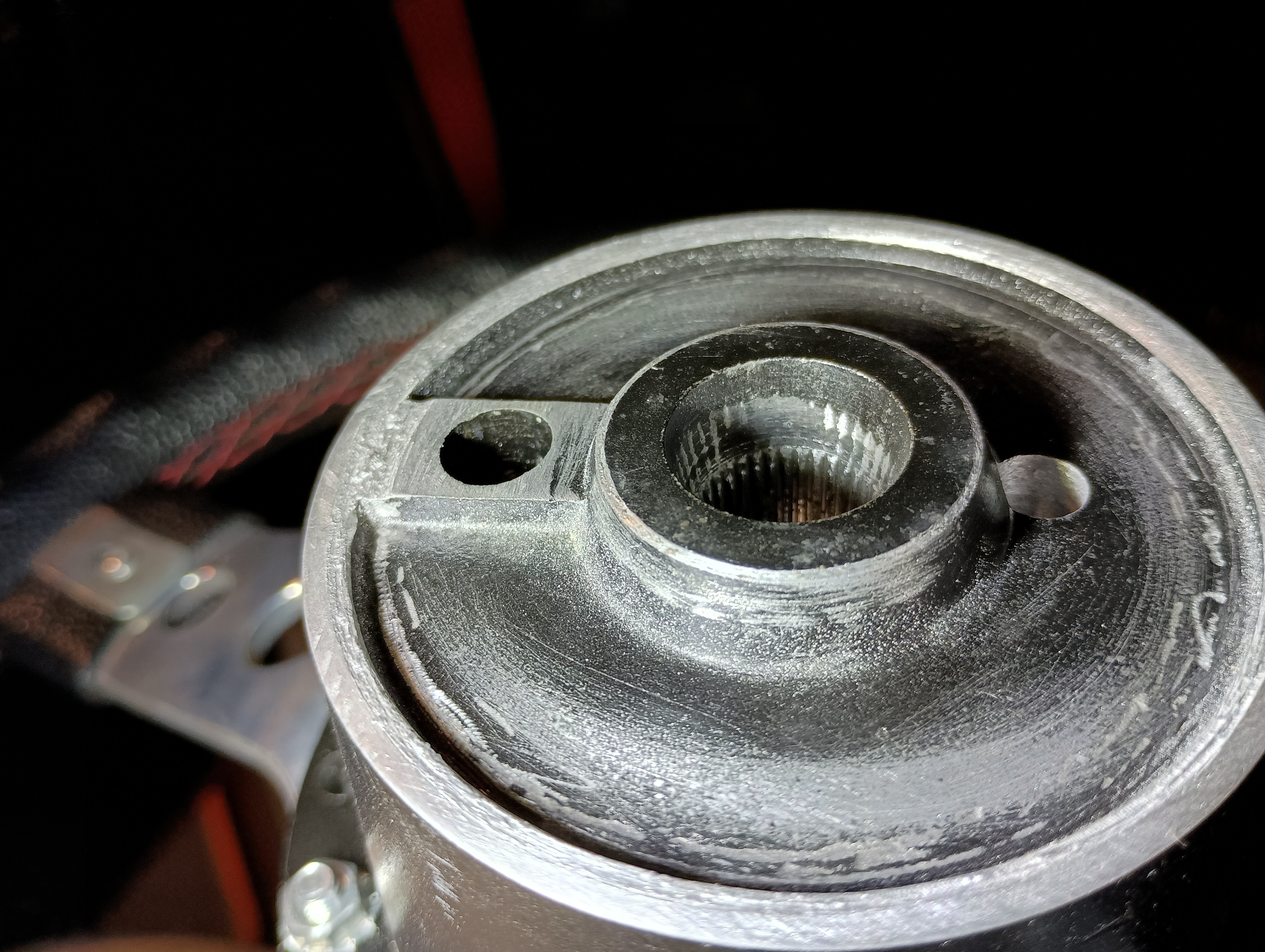

I bought Moto-Lita wheels for my 2 TR4s ( same steering wheel set up) and had the same issue. I found that the underside of the new wheel had a raised area that was causing the problem. Try removing the pencil connector and see if the horns still honk. If so, I ground down the raised ridge so that IT did not come in contact with the brass plate.
Charley
Had the same issue, same solution Charleyf posted, grind down the wheel hub.

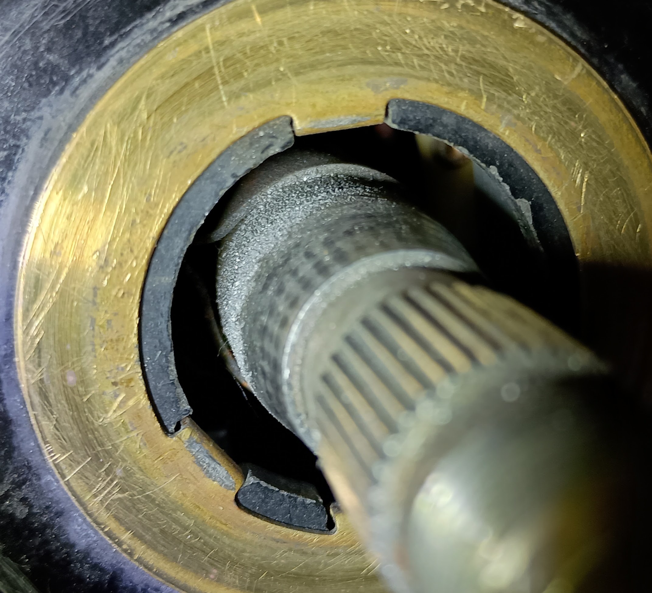

Hub hits the contact ring where the tabs fold over to hold it on
You can see the wear on the contact ring, I ended up grinding the hub more than shown.
