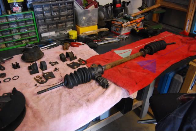

these are the parts of my rack.
anyone know how many turns lock to lock on a stock 75 spit? mine is about 3.5
thanks
