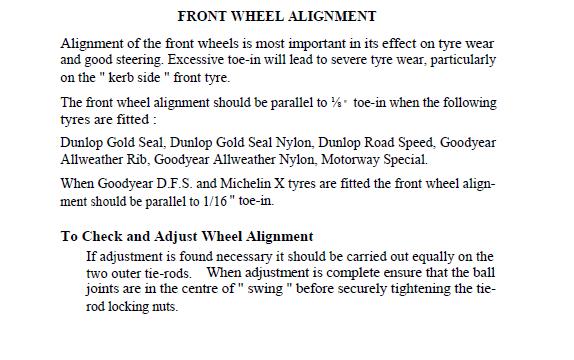

You need to be aware that toe-in is somewhat dependent on the type of tires that were specified.

For standard front suspension set up the tracking for between parallel to 1/8" toe in. Q.E.D.
Also this from "Practical hints for the maintenance of the Triumph TR3", Instruction Book,Part #501528:
