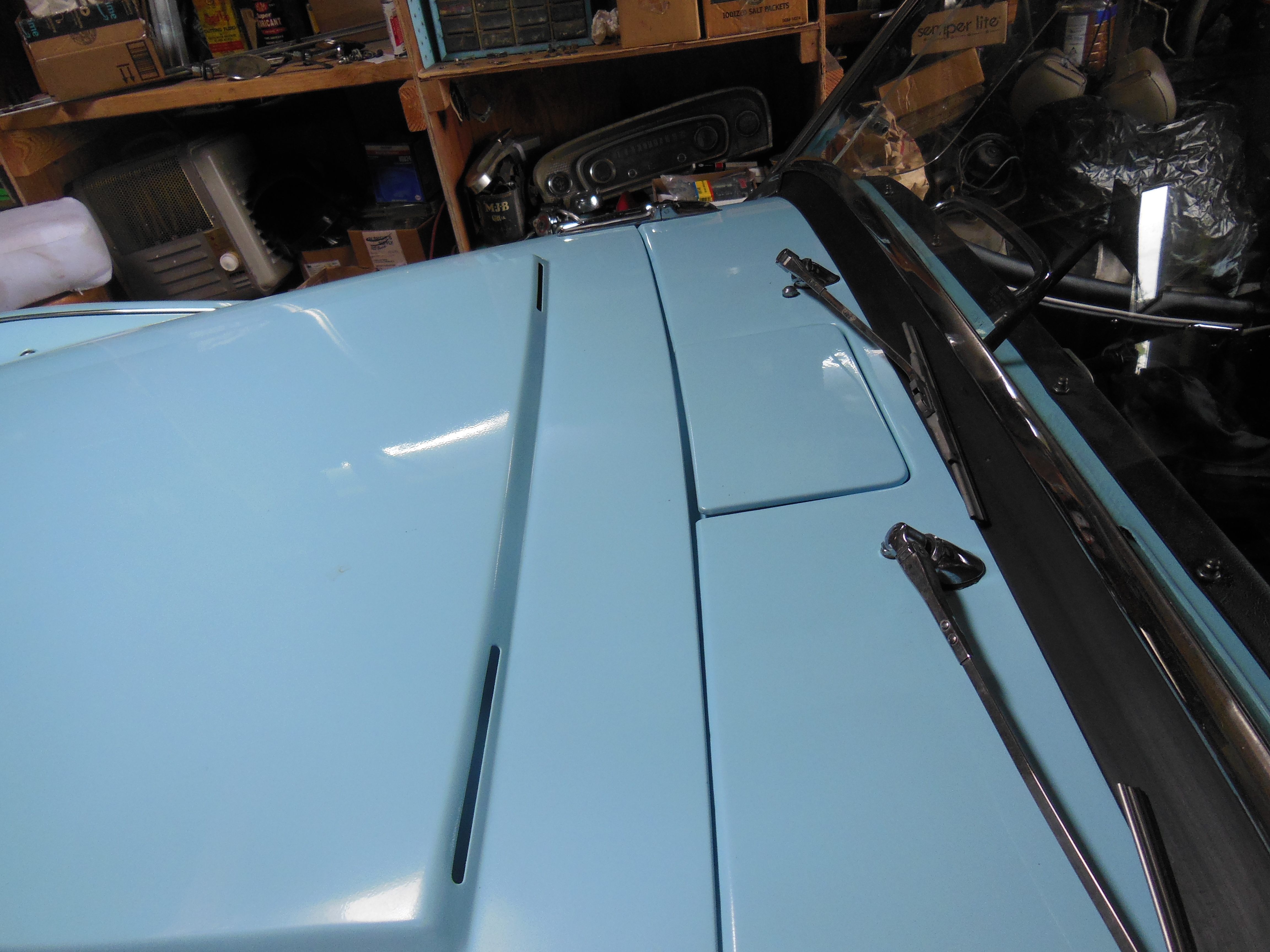

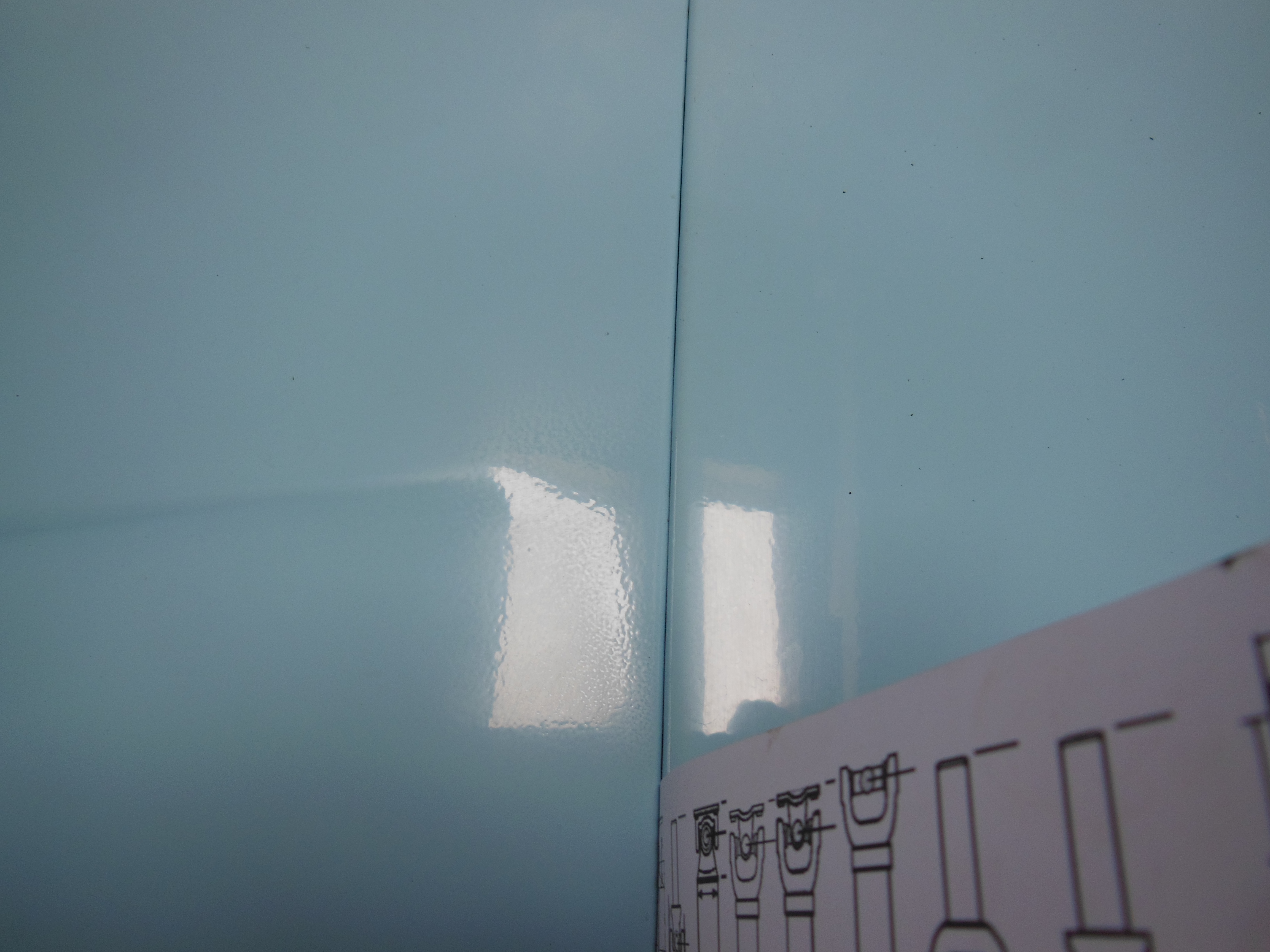

Now for the interesting part, the tightening of the nuts shifted the hood and door body gaps. The hood is too tight in the front and actually stuck. I cannot get a piece of paper in the gap. The doors are a little uneven. I should take some pics.
I am very concerned about opening the hood without chipping the paint because the hood is stuck against the apron. I think I can loosen the hinge bolts inside the cab, but the duzs are holding the hood in place in the front, so if I did loosen the hinges in the back the hood probably would not move until the duzs are released.
A more conservative way would be go back and loosen the U bolts and see if the tub moves back then open the hood and play around with the alignment. Perhaps I can lift the front up and it will drop down that little fuzz and I can open the hood. Any ideas about opening the hood are very welcome.

The body seams were very tight to begin with maybe 1/16 of an inch. This was my first-- cut the car in half--- body job, and I wanted tight seams and perfection, so I could be cool, and I made a lot of work that was painful and problematic. Losing my coolness too.
Anyways, I guess I will loosen the rear axle up some, to see if that frees the hood; it is the smartest bet I see. When I pulled away for the test drive, the hood rattled for the first time then stopped, looks like it went down some weird, but I went for it away because I needed to know.
Seems to me, the spring arched up-- when I tightened the U bolts--- and pushed the back of the car--- up and forward a 1/16. Hope so, this car has been a great teacher plus all the help here--- heck John basically taught me how to paint online with this forum on that car .

I am baffled that tightening the springs could affect the gaps.

I need to re-synthetize my theory. My latest version is the hood was lose and slid down to the apron either by twisting with acceleration from the lose differential or the hood bolts were not tight enough. Yesterday I loosen the U bolts and it made very, very little difference with hood, so I went to loosen the hinge bolts from under the dash on the hood and they were not tight either. I carefully opened the dzus fasteners and pushed the hood back toward the windshield at the same time with everything lose and got a nice 3/16 cap at the hood and apron then tightened the U bolts again and everything is fine.
