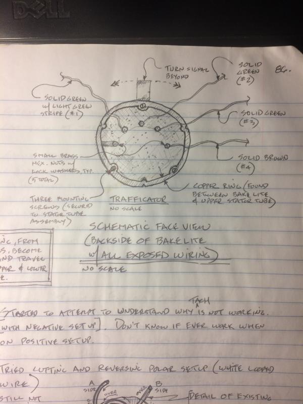

One good piece of advice I will offer you is, even with the best workshop manual out there and whatever videos that may exist in further aiding removal of your steering assembly, I always made it my habit to take progress photos of every step taken when taking apart, especially when it came to removal of the trafficator. I also went further to tag each wire by their color and their respective location. Many photos and notes. Very important. It makes reassembling effortless and painless. It is not going to be fun reassembling only to find new issues come about.

Here is another example of what I was suggesting in terms of taking photos, notes and even making sketches, as I like to do. This sketch worked for me (simple as it may seem but served me well when it came time to reassemble the trafficator, considering I had more than just one "green" wire to deal with)...Other factors to consider but hopefully, the sketching idea can also aid you in some way as well.

Thanks Paul good advice, I would really like to know if the connections you show really need touching or can it be done by disconnecting at the steering box end and pulling up as one unit disturbing as little as possible? Everything is working as it should at the moment I would not like to break the trafficator it looks a bit fragile and parts don’t look easy to locate.
mgtf328
I think you'll need to remove the trafficator to remove the steering wheel to get the box out of the car. You can disconnect the wires at the box and pull them thru the column with the complete trafficator. It's easier if you remove the bullet connections and tape the wires together. I'd advise attaching some string to the wires so you can pull the wires back thru the column.
