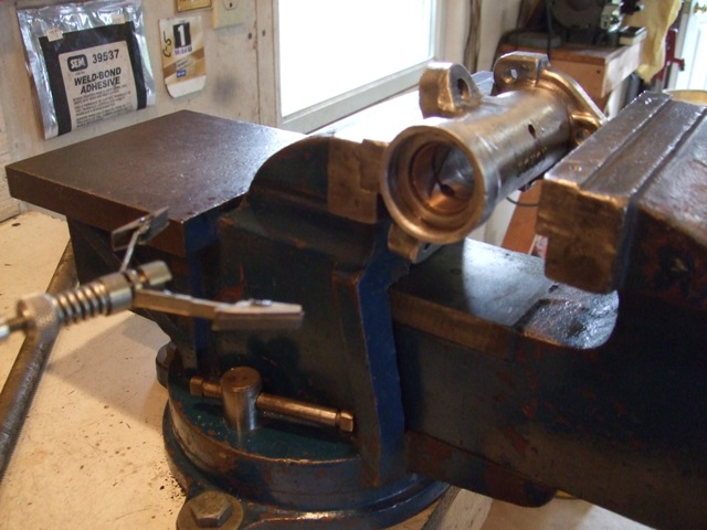

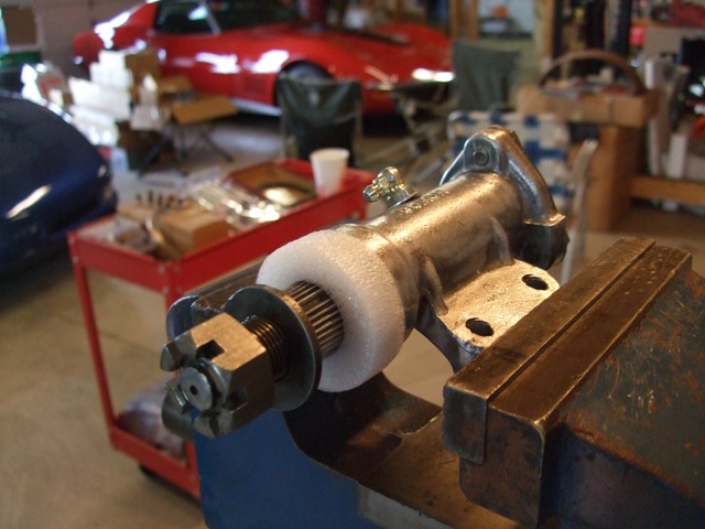

Yep, do that. This is what it looks like. Be sure to shim the zerk fitting with a thin washer because its threads will go too deep and groove the shaft if ya don't. If your idler arm and shaft are moving up and down your bushings are shot. You will drive the new bushings in place then hone them some until the shaft fits snug but not too tight to turn.

Marv thanks for offer but so far with help from people on here I may have solved problem. I took cap off and backed off filler plug so it could not hit shaft and also filled it with grease. Sounds good so far. Thanks Marty
Zerk fitting seems to be the way to go in future but after taking top off, backing off plug, and filling with grease sound seems to be gone. I would like to maybe put bushings in someday but the honing word scares me. It that tool something I can rent at auto parts store? Will look up on Internet to see. Thanks Marty

I 'mis-wrote;' I was thinking reamer (most auto machinists will have a set). I wouldn't use a hone for this, if it worked for you, good.
Edit: Did you hone your king pin bushes the last time you replaced them?

When I bought my BJ8 spindles, the kingpin bushes were already honed to size. I only replaced and honed my steering box bushes. My idler has been good except for adjusting the vertical play by removing a shim or two.

Honing is appropriate for breaking glaze on cylinder walls and cleaning up minor pitting on brake cylinders, but king pin bushings should be reamed. The bushes themselves need to be carefully installed so that the greasing passage aligns with the channel on the bushes, and the bushes need to be exactly aligned with each other. You need a reamer to do this:
https://mossmotors.com/reamer-swivel-pin-bushes
If you can't find someone local to do it, BCS can do it.
