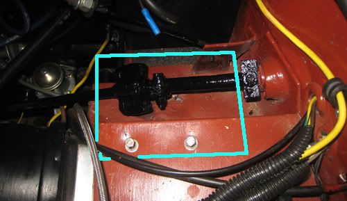

I have read from several members problems related to the steering
column "knucklebone" wrapping/grabbing nearby
wires and causing breakdowns.
My own TR6 had two very nasty breakdowns as a result
of the steering column knucklebone grabbing primary
ignition wires and tearing them apart..

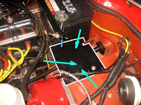

Here is a knucklebone FIX I came up with that took maybe 2 hours
to fabricate and install. It has worked perfectly
and protects my wiring harness, clutch hydraulic hose, etc.
from the dreaded steering knucklebone.
I used .080 aluminum stock, cut and shaped to fit on my
grinder and secured in place with two existing thru-bolts.
It works great and I've no more "knucklebone" related breakdowns.
I highly suggest to install one.
dale
The knucklbones connected to the ..........
Yup!!
Breaking down in the middle of an interste cloverleaf
intersection was pretty grim.
It won't happen again due to the knucklebone!!
d

<span style="color: #660000">Paul, two breakdowns in the middle of super heavy traffic was enough for me. I covered
the steering wheel knucklebone with a plate and was done
with it. I know some other BCF folks have had problems with the steering knucklebone eating wires and cables.
A very simple upgrade everyone could use.
dale</span>
I agree with you about the breakdowns, but the important thing is to keep all wires secured and away from that area and there will be no problems.
I had the ultimate knuckle breakdown...it broke completely once on my TR4A. I had just finished a spirited jaunt down the highway and pulled into a McD for lunch. Turning the wheel while stopped to pull into a spot resulted in a spinning steering wheel :shocked: Good think I always carried a spare coat hanger :smile:
