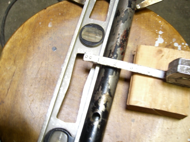

This car is 1958 and that seems to be the year the steering change to a split column towards the end. The solid column I have has a ¼ bend in the shaft probably from a collision and my thoughts are it should not matter, but it might put pressure on the bearings. What do others think? I am not trying to do an exact restoration and have a split column to use also. In the end the split would provide easier removal if there are problems, so that might be the way to go

The bent column may not be a problem and since it is near to the oil filler hole, you may be able judge if the actual shaft rubs at all.

If I were not worried about originality...and even then, if I were planning to drive the car a lot, I'd toss that long column. Every time I sit in the TR2, I picture what that one piece column would do to my chest if I run into a curb or such. At least with the 2 piece you have a chance of the column buckling before it skures you. Add the bend in your case, and I would prefer the split column.

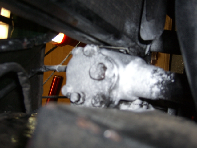

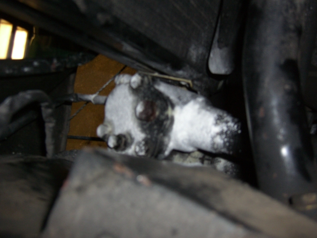

Here is trick I learned a while back, clean the area up good with degreaser and fog some bay powder on it and wait. The leak is in the large plug at the top. I used to think that was a fill hole, but the more I look at it the fill hole up the column would get oil on the rear bearing. I did not replace the seal on the large plug and now I am fixing a mess.

I have a place that sells the 518 in large tubes, and they last years. It goes really far, so even a small tube would be plenty. I learned about it when I was rebuilding German "boxer" style engines. On those the crankcase halves join metal on metal with no gaskets...just the 518. Since then I use it on all the metal to metal joining I do. I like your leak checking!
