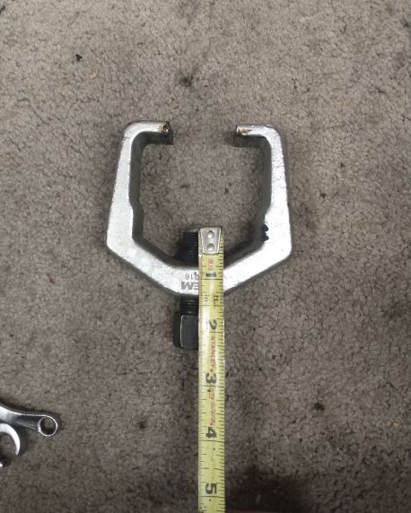

This is the same I rented/bought from autozone. I cut about 3/4 inch off the screw, then ground the end to a slight point. This makes it easier to get to the end with a wrench and helps it to not slip off the shaft. I didn't grind it to fit on the two nubs on the arm. I maneuvered it so the nub on the inside was against the puller and the other side of the puller was on the top edge of the pitman arm. This way the puller was tilted outward so it was easier to get a wrench on it.
This is the puller I rented/bought from Autozone. I cut the screw off shorter.

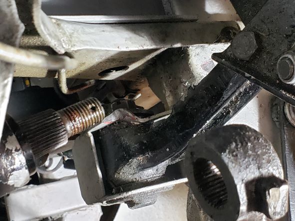

Good news I got steering arm off but bad news is I damaged A-arm on frame in process. Looks like weld is still good but to do it right I have to remove coil spring to make repairs. What a mess. I was in a hurry and that part was in the shadows. Marty

I like the wedge idea,,,, but I would worry about hammering against the shaft of the steering box. With the puller there isn't any pressure on the shaft or box. Pulling on the arm while pushing on the shaft equalize the pressure. I found a PCV fitting that fit perfect to pound the seals in. I did get both of the Moss seals in.

Yes, IDEALLY, when clearance allows, you'd use a puller imparting loads on ONLY to two (2) components involved. But when using a puling results in damage, causing addition work/assemblies to be removed, well, you get the picture... ;)
