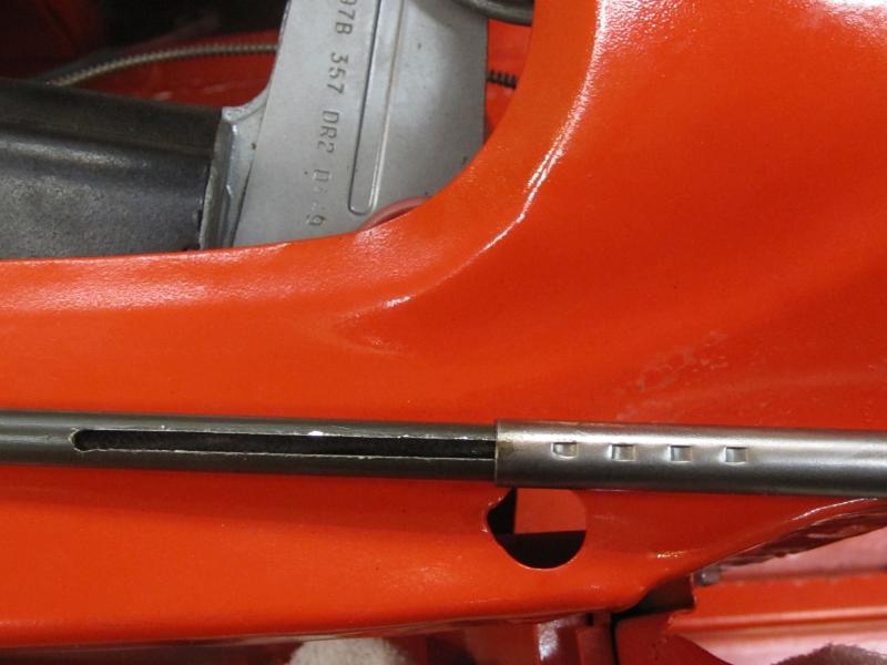

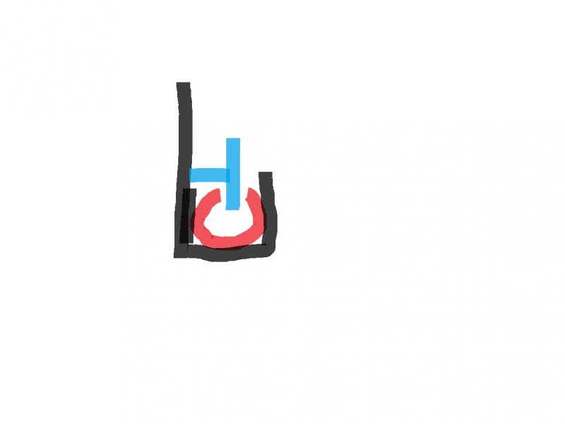

Thanks, that 'splains it. When I've removed them, there is usually a ridge on the olive where it seated, meaning I could re/use them exactly twice (they do need to seal oil in the box). Maybe I'm over-tightening, but it's all that keeps the trafficator from rotating in the hub.
