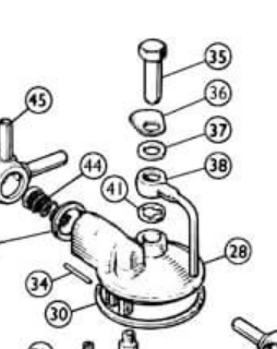

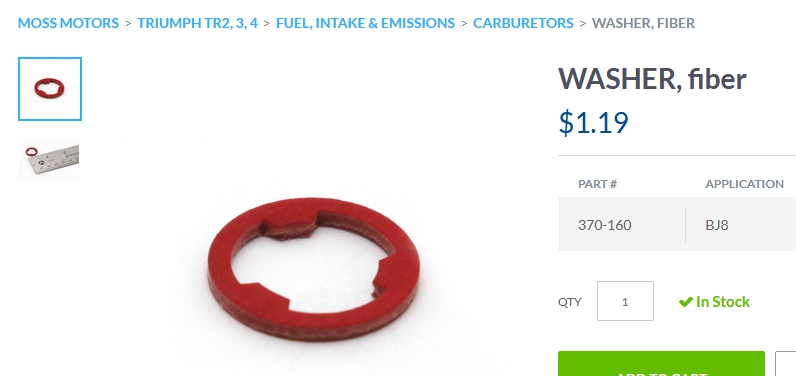

Edit: Tahoe makes an excellent point. If both the fiber washers (item 41) are incorrect solid washers, it could keep the carbs from functioning.
